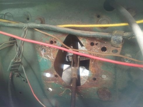

Well I need to know if a 1964 f350 firewall should look like, should it be the same as a f100 or f250 or is it different where the brake booster is mounted. here is a pic of mine.

sorry I should have checked it before posting, I have a 1964 f350 that needs a master cylinder I wanted to upgrade to a two pot one. when I removed the booster it had a home made bracket bolted through the firewall into the peddle support and the irregular hole in the picture. the outside holes are the ones that go through the peddle supports. There are master,booster, bracket kits out there but most just say f100 and f250 So I need to know if the firewall is different on the f350 or is mine just hacked up Sorry again for the gibberish in the first post

I cant speak for the bracket you talk about but that irregular shaped hole looks just like mine, I'd say it was suppose to be like that.

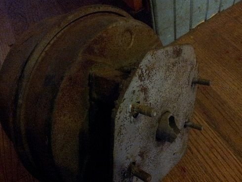

thanks for the replies. Ihcc what dose you brake booster look like how is it attached to the firewall here is a picture of mine and the hokie bracket

Here is my spare booster that I bought a while back for a spare and also the best pic I had of my original one mounted

Wow that is just what I needed. at least I know what I am looking for Thanks for the information.

From what I can tell the bracket itself does not have its own P/N and only was available with the complete booster assembly. The P/N for the booster is C4TZ-2005-F or C4TZ-2005-D depending on your trucks S/N. Hope this helps, good luck finding one!
