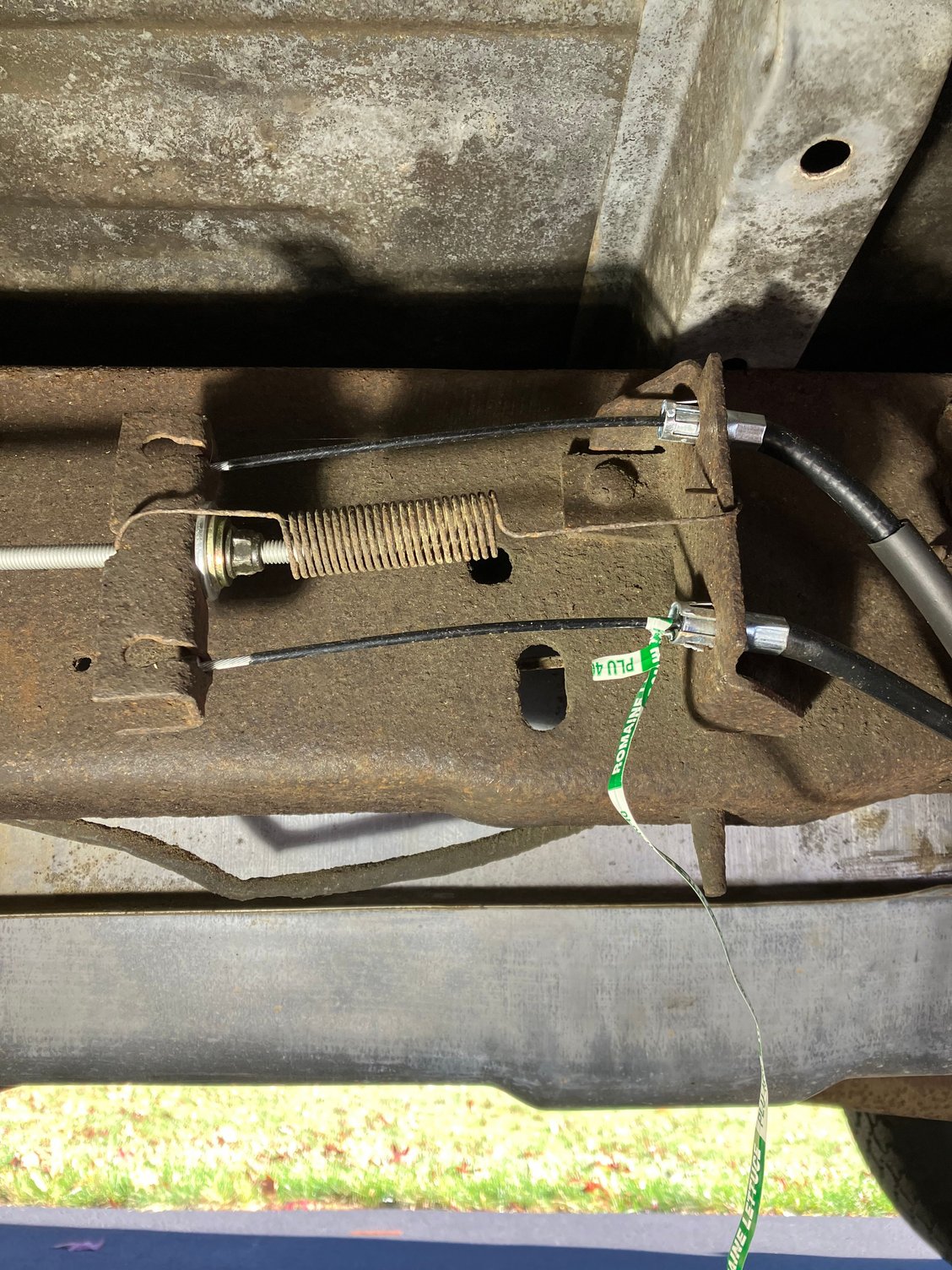

FWIW I replaced the parking brake cables and adjuster last fall. The green/whitetag shows how much movement it get when stepping on the E-Brake pedal

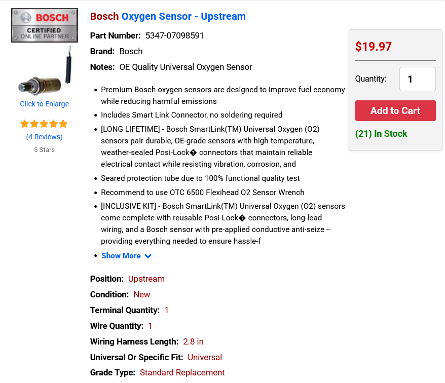

You need the correct O2 as per vehicle assembly (CALIBRATION CODE). The ECM will most likely not read a heated sensor. It was not calibrated for that.
The PN I showed is a BOSCH sensor and should be available down there. Ask the parts dude to run it.
Have you removed the old sensor? If so and it is FORD, there should be ID NOS. on it.
I don't think either AU or NZ uses the same PN SYSTEM for this period vehicle as US.

One thing with my equaliser...when fully set up and connected, it's not anywhere near vertical like yours. One of the cables comes out from the mounting plate quite a bit more than the other, meaning that the equaliser is angled almost 45 degrees off the vertical to take up the slack. Would that make a difference? It was the same when I had the old cables connected. I figured the cable had stretched somehow, and it was the main reason why I replaced the pair of them; but as I have the same issue with the new ones, I guess it's not that. Should I weld a spacer of some kind on the equaliser so as to make it sit more vertical?

Thanks again for that o2 sensor part number...I gave it to a dealer and he thinks he can find one.

What I meant is if the O2 is marked you can cross it to a FORD PN and search for it NOS on EvilBay or the like. If no, you want BOSCH.
Make sure he checks his cataloging to make sure it will fit.
