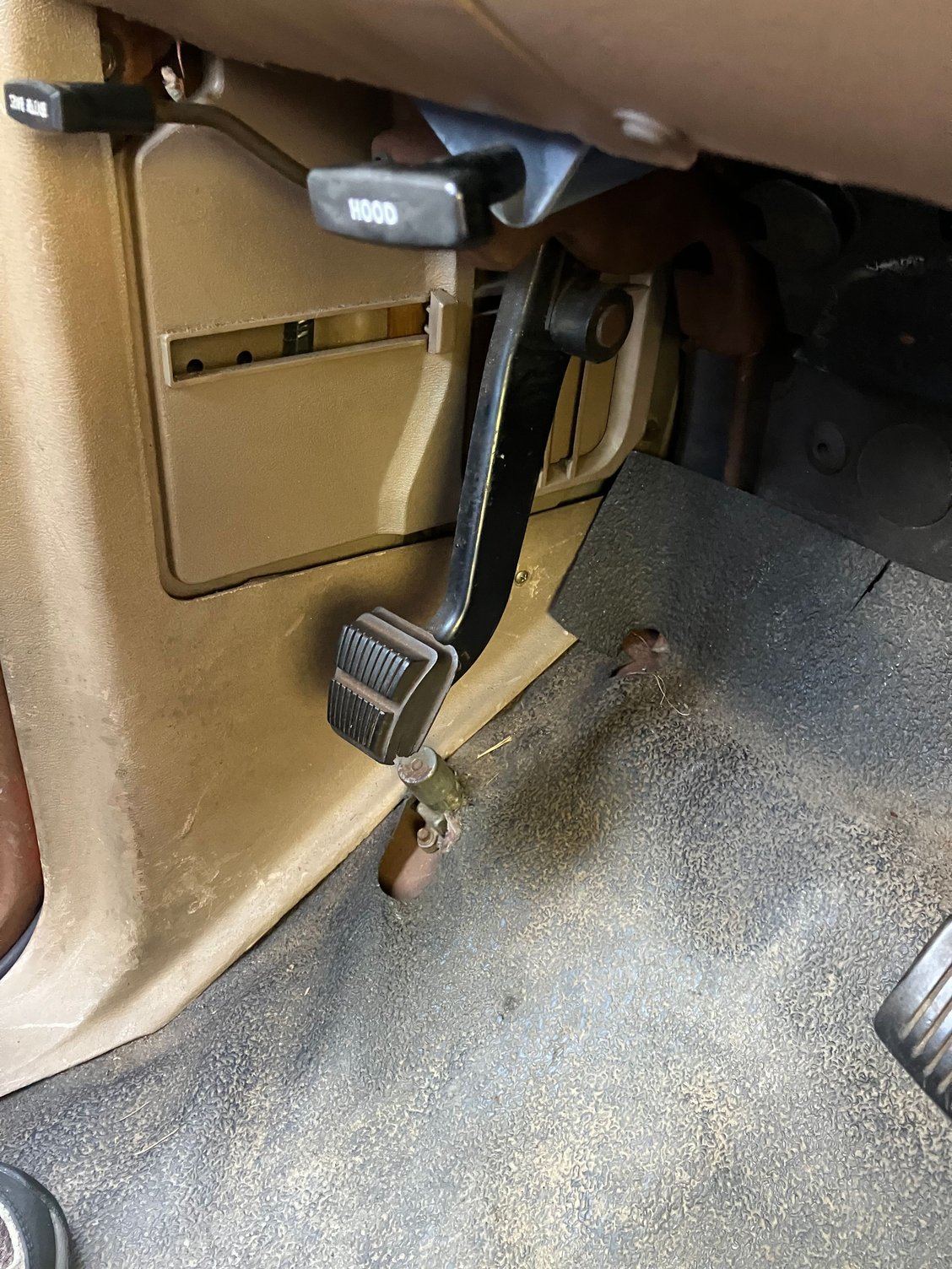

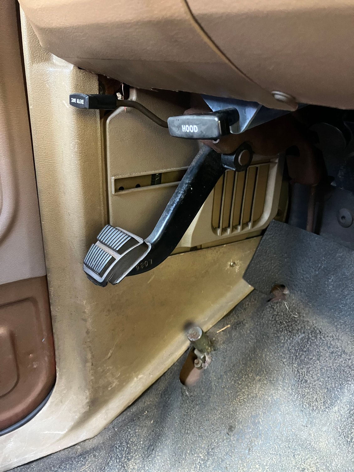

I'll also add, my parking brake pedal doesn't go down very far, as some tend to say. Maybe its time to go out and get a photo...

I took a look at mine. The equalizer bar is not vertical. Maybe 20 degrees. Works fine.
