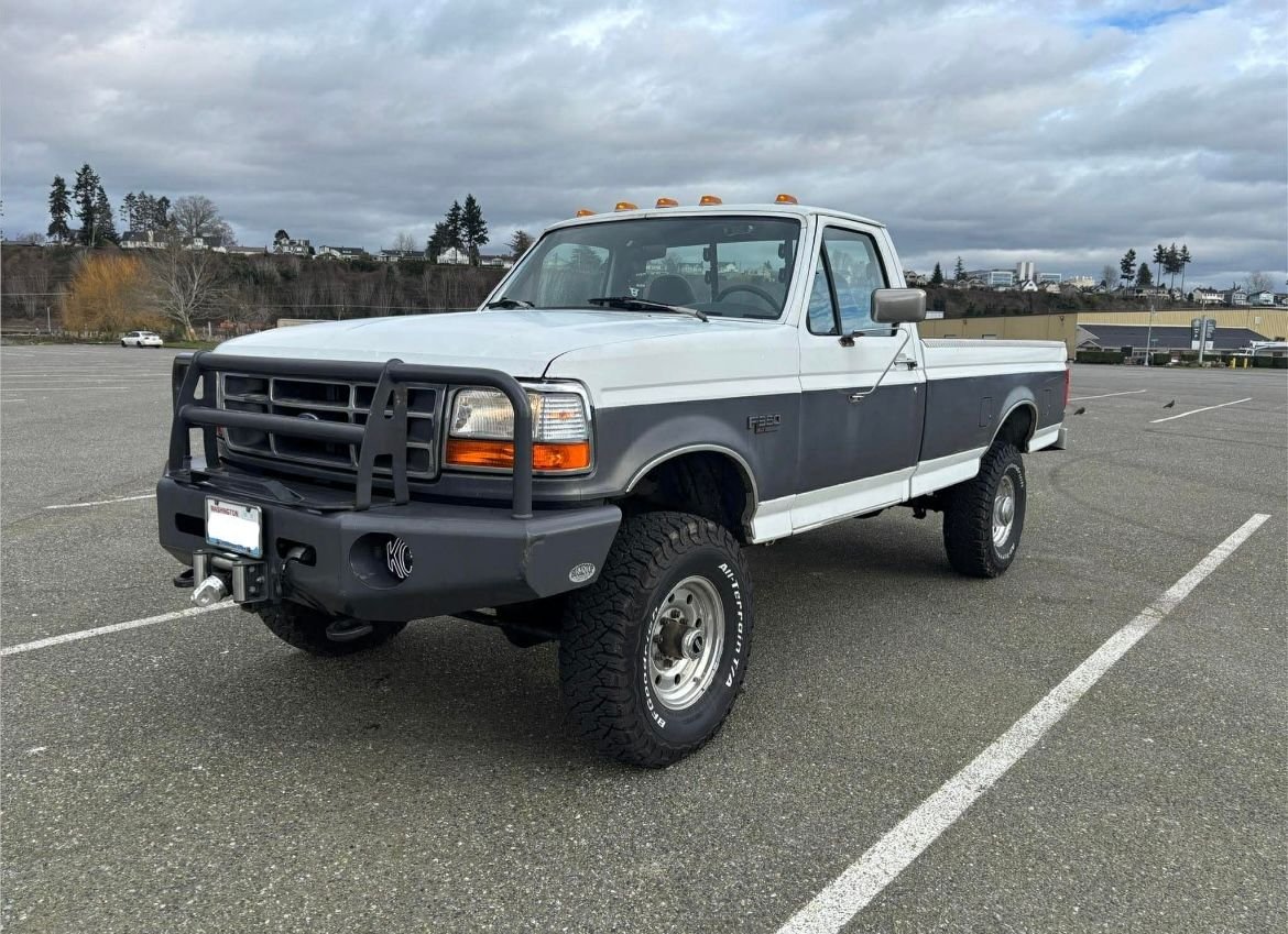

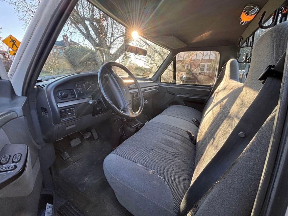

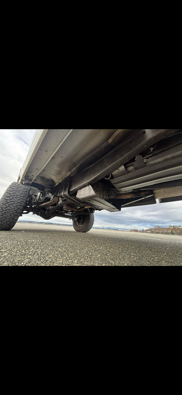

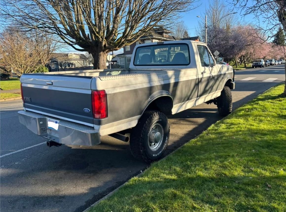

Been looking at 7.3 power strokes and idi's for a long, long time. I am finally in the market to purchase one and have come across a very clean 1993 RCLB, 5 speed, 4x4, 7.3 idi, f350. I was given a cold start video which will be attached, seems to crank a little long to me. Could be air intrusion etc... I do not know, as I have yet to lay eyes on the truck. Does it sound normal other than the long crank? Attached also is a photo of the underside. Frame looks to be painted, but no pitting. Body looks immaculate!

The interior looks clean, underbody looks great, manual +, and 4x4, yes confirmed, the startup and engine does sound normal. .. do check everything out as you should, but going off that little bit, I see no problem, If everything else does look good, go for it.

Oh, I almost forgot! Dang, that truck is clean! If it all looks like that, pay the man whatever he wants. You'll have it for decades to come if you keep it off the salt roads like he clearly did. You'd be hard pressed to have a 9th gen Ford truck restored for 10k, even doing it all yourself. Depending on what you started with, it's not likely you'd be able to do so.
