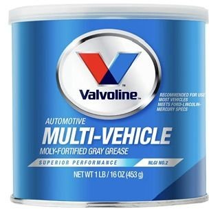

Originally Posted by Scndsin
I use grease only rated for Ford disc brakes which is typically moly grade.
Packing by hand if done correctly forces old grease out of the bearing.
YRMV
I use this since it has the Ford spec on the label.
Absolutely. You can see any old grease being forced out.
