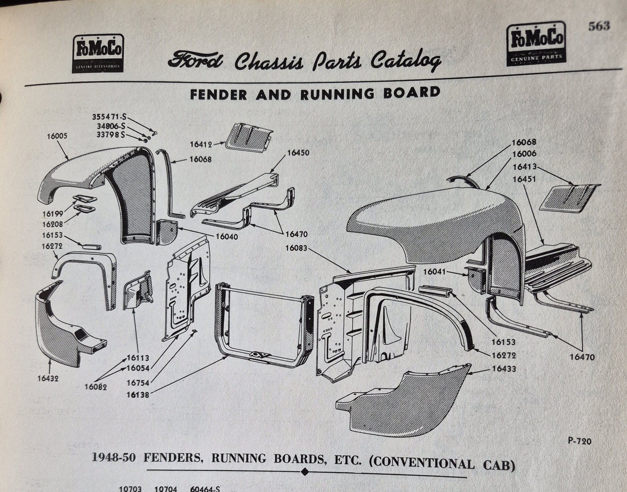

You may find these drawings from the chassis parts catalog helpful, too.

When you mention welting, if you're talking about the beaded welting that has an exposed bead at the seam after it's installed, that was never used by Ford on our trucks. All we ever had was the tar impregnated anti squeak webbing/welting to keep the panels from rubbing against themselves.
For assembly order, fit the pieces in the grille drawing together, then fit the fenders/inner fenders to it. Add the rad support and the fender braces, then install the complete unit onto the chassis. There may be other ways and someone else may have a different suggestion, but that's how I would roll. Study it all good and see where the 12 million bolts go around the grille and fenders, then make a plan of attack and go for it.
