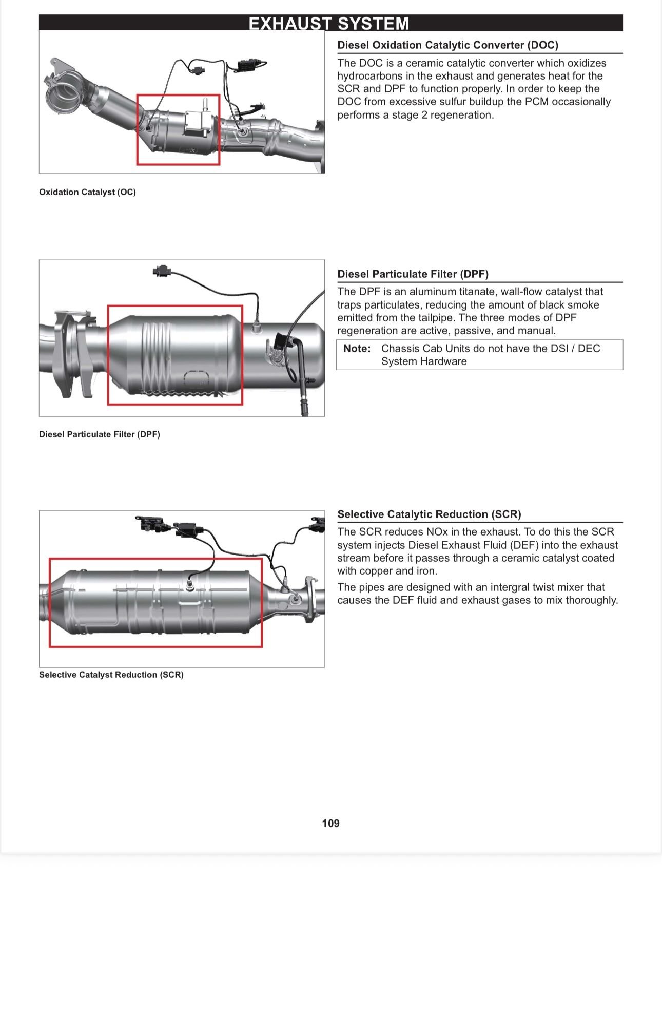

Sorry, my only point was the DOC and SCR plug up with soot. This is described in the 23+ coffee table book and managed using this type 2 regen. The pre-23’s not having a 9th injector basically always do a type 2 regen, automatically taking care of any soot that collects in the DOC and SCR every regen. If you delete but leave the DOC I assume it will eventually plug up unless you figure out how to do the occasional regen. Maybe it’s as simple as doing a manual regen every 1500 miles or something. Unfortunately the coffee table book fails to mention how often a type 2 regen is required or what triggers it. I watch EGT11 on my 24 during regens looking for abnormally high temps, a clue a type 2 is in progress. Still watching and trying to figure it out.

Question... what are you referring to when when using the acronym DOC and SCR ? Sorry I'm lost at the moment but usually in print things like this are referenced in full verbiage when first used and then acronymed afterwards !
Speaking of older diesels and smells as compared to todays diesels, remember you're not dealing with "1" the same engines and "2" not the same fuels !

This should explain, from the 23 coffee table book:
