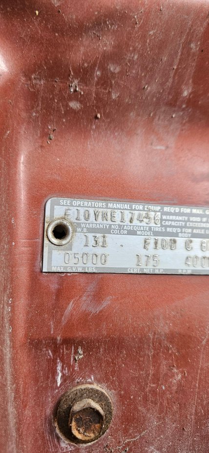

Decoding 1960s vin to determine model year
Exactly as title reads im having a hard time telling if im working on a 1969 or if it was a clerical error at the dmv back in the day on the registration, Google is very confusing.

E17456 is October 1968 assembly month for the 1969 model year.
Decoding Your 1969 Ford Truck VIN - FORDification.com
