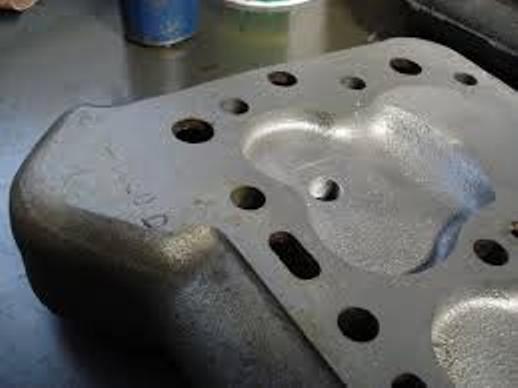

I'd contact the local Early Ford V8 Club, they will know who has the experience.
Before you have the heads cut, check to see how much they've already been cut. Few heads have made it 70+ years without at least one cut. You can gauge whether they've been cut by looking at the front underside of the heads, near the thermostat housing. See how much of a ledge is left, see pics.
This head has not been shaved, or very little:
This head has been shaved quite a bit, enough that there is no ledge left:
