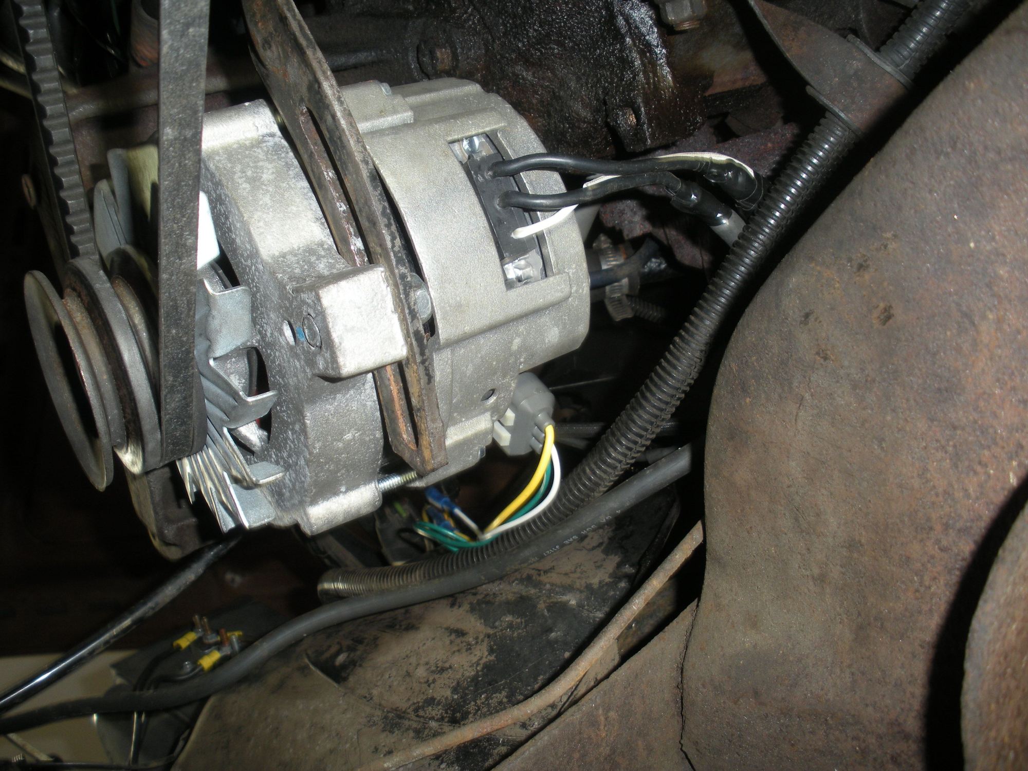

My truck has the 2G alternator with the on board regulator. It has plugs that attach to the alternator. Some people have said the plugs come loose and can cause fires. If you have the 2G be aware that they can be clocked in different orientations. Make sure any plug ins are on the top or side of the alternator. If clocked wrong I could see a plug vibrating out. But mine have stayed tight and right because they are assisted by gravity. I do know that the same alternator was used on different vehicles and was clocked differently for them. So if you get a 2G replacement be sure to take your old one with you. Otherwise you could walk out with one that might not work well for you.
I wasn't going to mention the 2G, but, here's mine. You can see the newer ones have the intergrated power connector, I also show the old voltage reg. connector and new one. I used male/female blade terminals (under shrink wrap) to make it easier to replace in the future if needed.
