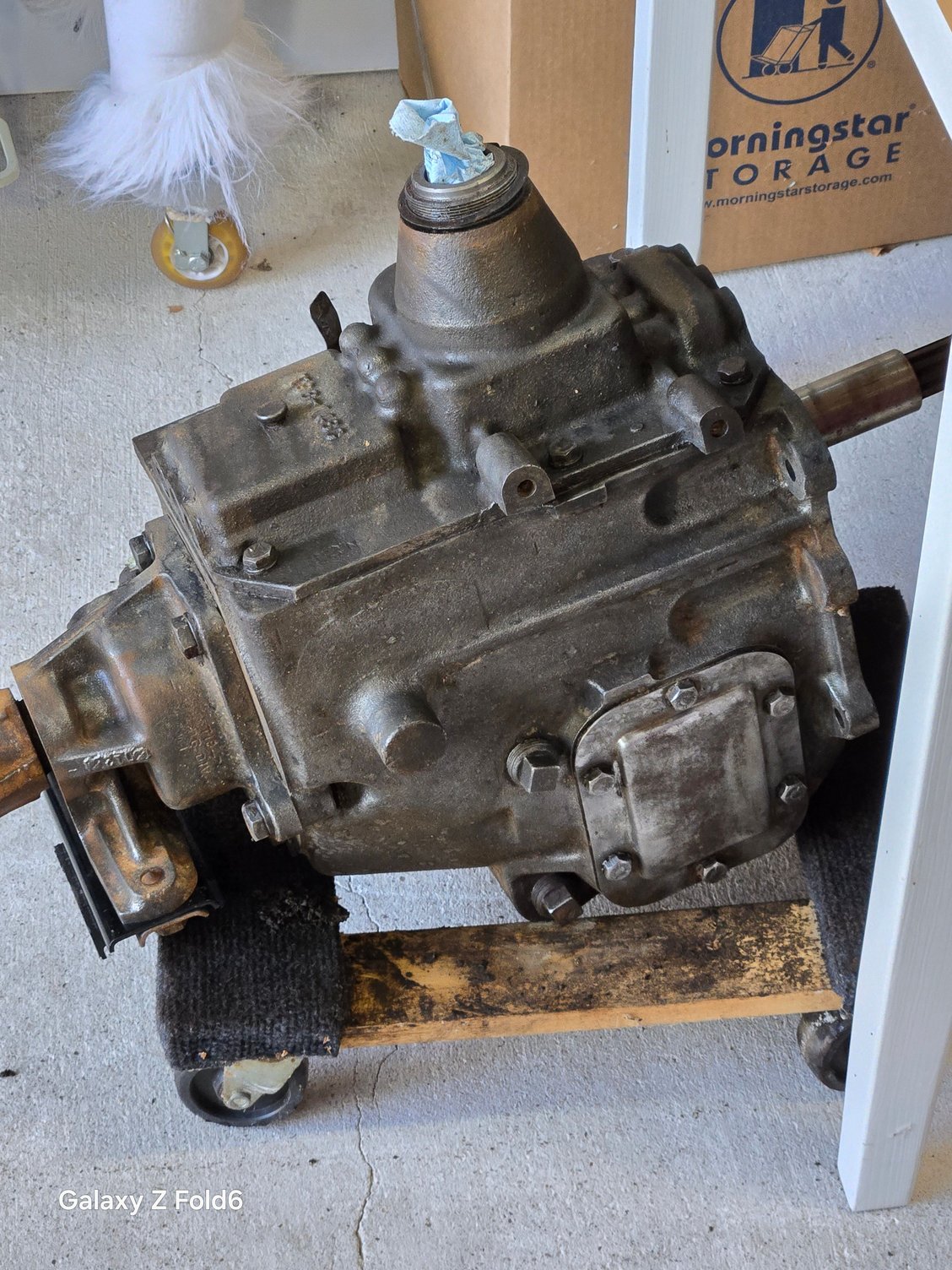

The new one will have to be just a cut up piece of foam since no one has it... cleaned the trans today.

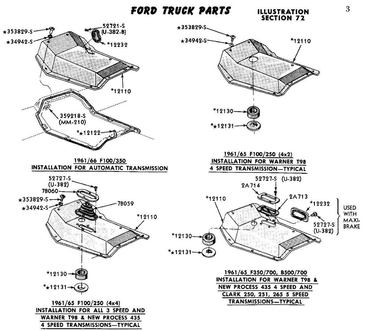

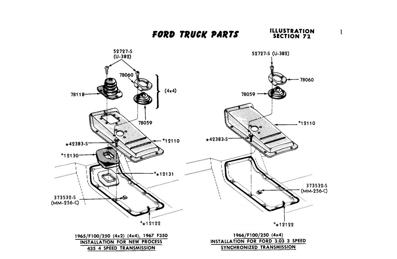

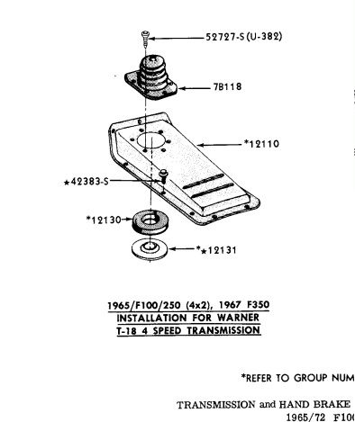

Not just a foam pad but should also be a support plate, too.

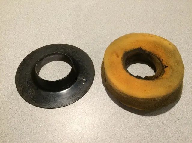

Yeah I have the plate as well... mine is a little different.

They did vary some but yours looks like it's generally round in shape. Some combinations came with a more rectangle or square shaped plate and foam. Just designed to keep weather out. Rudimentary but it helped.

Mine was soaking wet with gear lube.... not the greatest design maybe. )

Foam oil filter.

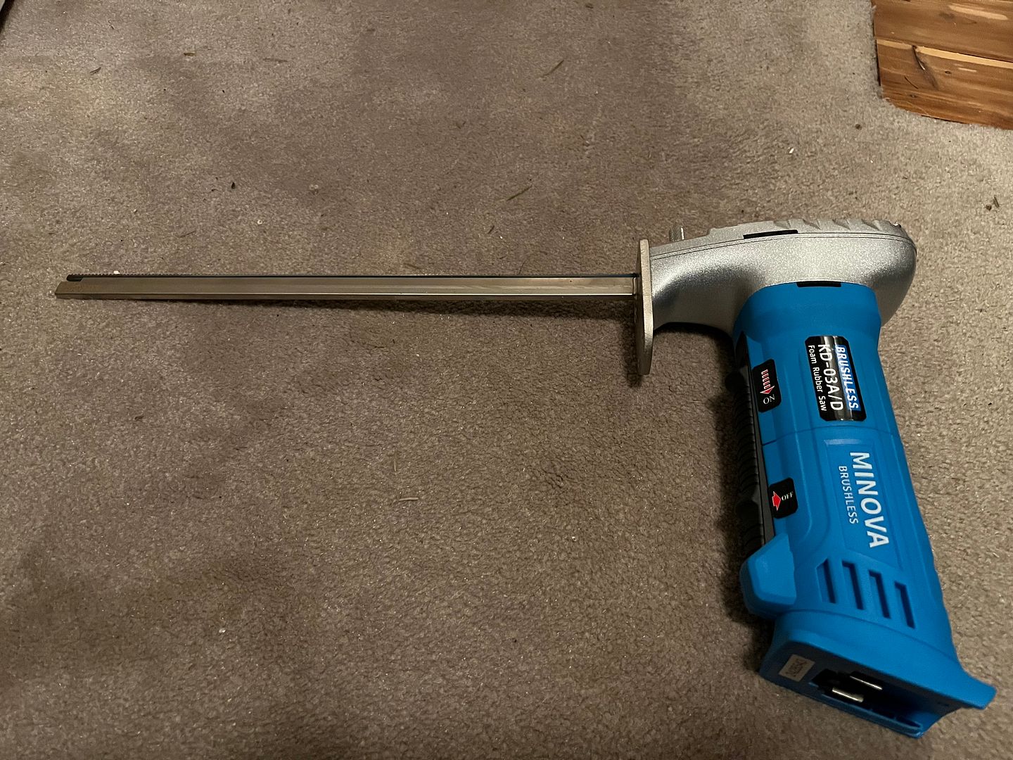

1" thick probably not really enough so might need two of those for one of these Ford trucks. Looks like a possible solution though.
I should make some of these - easy to cut out with the 12" foam rubber saw.
