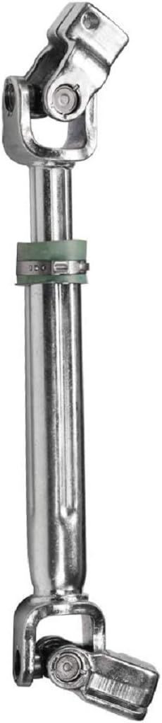

Spray the steering shaft ujoints generously with rust penetrant or chain lube or whatever is handy before crawling underneath the truck. Drive it around the yard and work the steering wheel, if it loosens up your shaft ujoints are running dry
Thanks for the suggestion, easy enough to try. I don’t really think it’s the problem because the truck has only 83k miles and is always garaged. However, I do live in the rust belt. There aren’t any creaky noises either. I was going to try and use a bidirectional scanner today to check PS pressure, but either my ECU isn’t equipped to give me readings or the scanner isn’t up to the task. Maybe both. I think I’m just going to replace the pressure sensor switch since it’s cheap and easy enough to get to.

I wonder why Ford got rid of the pressure switch, just not needed? My 09 has, my 10 doesn’t.
You have to remember the age of the truck, the ujoints can just slowly dry up without any noise. Some report the shaft binding, others don’t. My brothers 06 had stiff steering and the pump was whining. I sprayed the shaft up and could feel it loosen up after about 4 turns of the wheel driving around the yard.
I am by no means saying it’s your problem for sure, but it’s easy to spray both ujoints up and go for a drive. Try it before spending time and money on anything else in the system.
I put a reman BBB rack in my 2010 because the steering was stiff, after a shaft replacement. It’s still stiff. Better but not how it should be. I also see Ford discontinued pumps and racks for these 09-10 trucks, that’s why I had to go aftermarket. I scored a used Ford low mileage rack but I think I still have warranty. I’m curious to see what your stiff steering cause turns out to be.

That reminds me, check the steering column intermediate shaft as well.... These were known issues as well.
I’ll definitely check into the shaft a little more thoroughly, although I sprayed with some penetrating spray this past weekend. I haven’t driven it yet on the street but it still acted different than normal. It’s not smooth, kind of uneven resistance is how I would describe it. I’m going to borrow a better bidirectional scanner from a buddy to see if the PCM will give me pressure readings before a spend any money. If the shaft is the problem, would it be best to replace it or just lube every so often?

If in doubt replace it, Ford replaced a bunch of them. Might even be a recall on them. I cant remember.

You can lube it just to get by until you replace it lol. My bro just kept his lubed every so often until he had time to change it.
It’s a pretty immediate difference after you lube them and work the wheel, if you didn’t notice any big change something else must be the issue

Scanner results were not helpful, it seems the pump pressure data is not part of the ECU. I could try to hook up an in-line pressure gauge, but that’s a lot of trouble. I am still leaning towards the steering shaft, but my left is tied up with another vehicle. I’ve been working on. Once the lift is free up I put the truck up and see if I can lube this shaft real good. If that helps, I’ll probably replace the shaft down the road.
