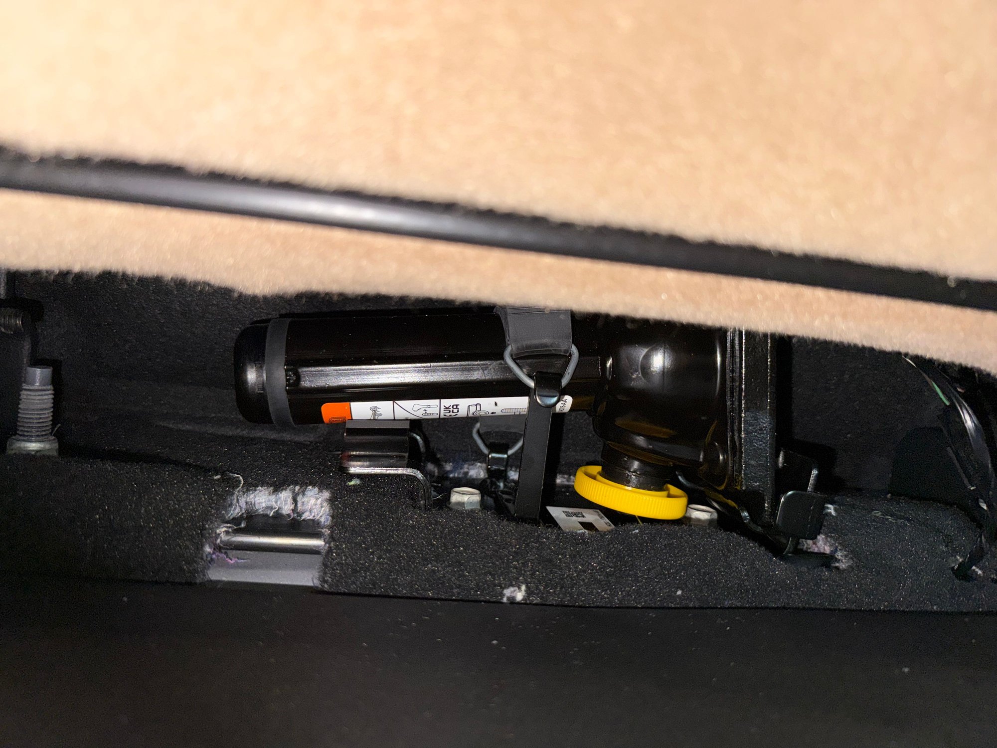

How the heck do you get the jack out of this thing? On my 2015, you could fold down the seat and get to the jack. I can see it, but that’s about it!

So on the edge of the seat back, you'll see a cloth loop, similar to the one that lets you lower the seat bottom back down if you raise it all the way. Give that a yank, the seat back will fold forward, and you can reach the jack easily.

Thanks 99. I thought the right and left seat backs were the same and that I would have to buy one of those kits for releasing the backs.

Nah, just the driver's side seat back is 'fixed' from the factory. The passenger side one folds down specifically for the jack.
