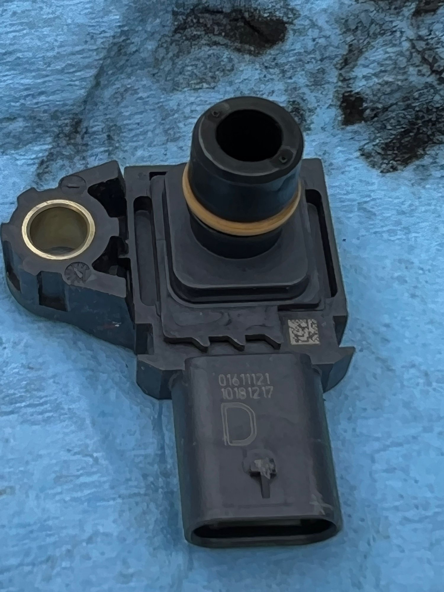

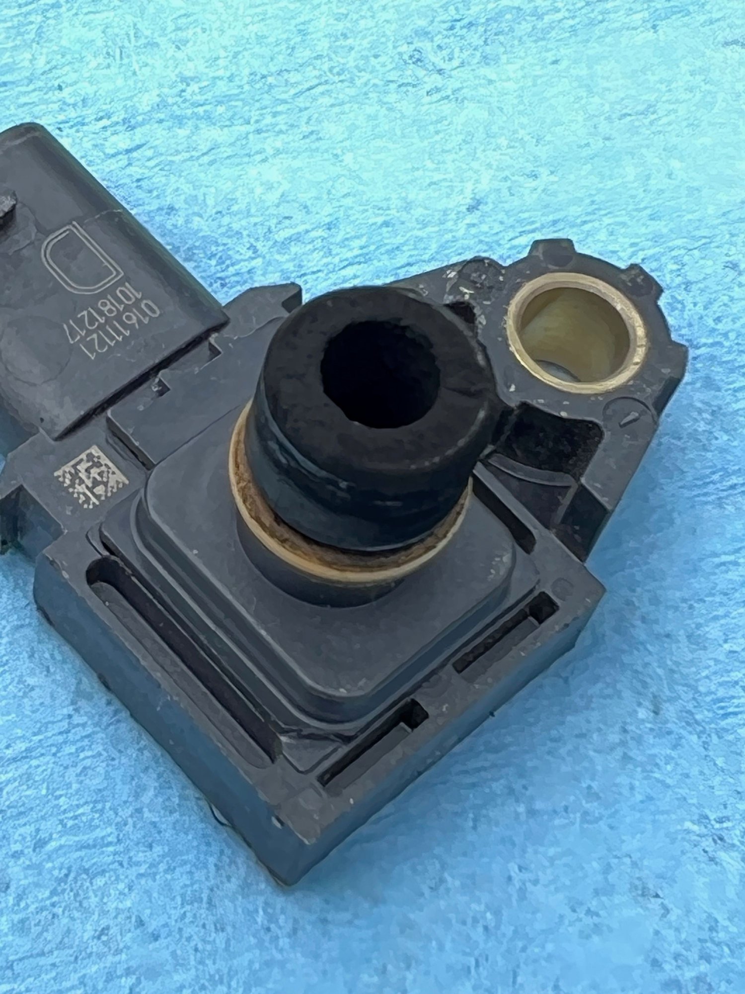

I cleaned mine at 20k and then again at about 50k when I installed the spacer. If you clean the sensor make sure that you use a cleaner that is made for cleaning sensors, such as CRC Electronic Cleaner Spray. Also, be sure not to shove anything down into the hole or you will disrupt the membrane and that will require you to purchase a new sensor. Here are some photos of mine at 20k. It still looked and functioned fine, but it was clear that carbon was already building up on it pretty well. It was about the same at 50k.
Before
Before
After
After

Heck, all I had in the garage was PB blaster, so used that to clean mine!
