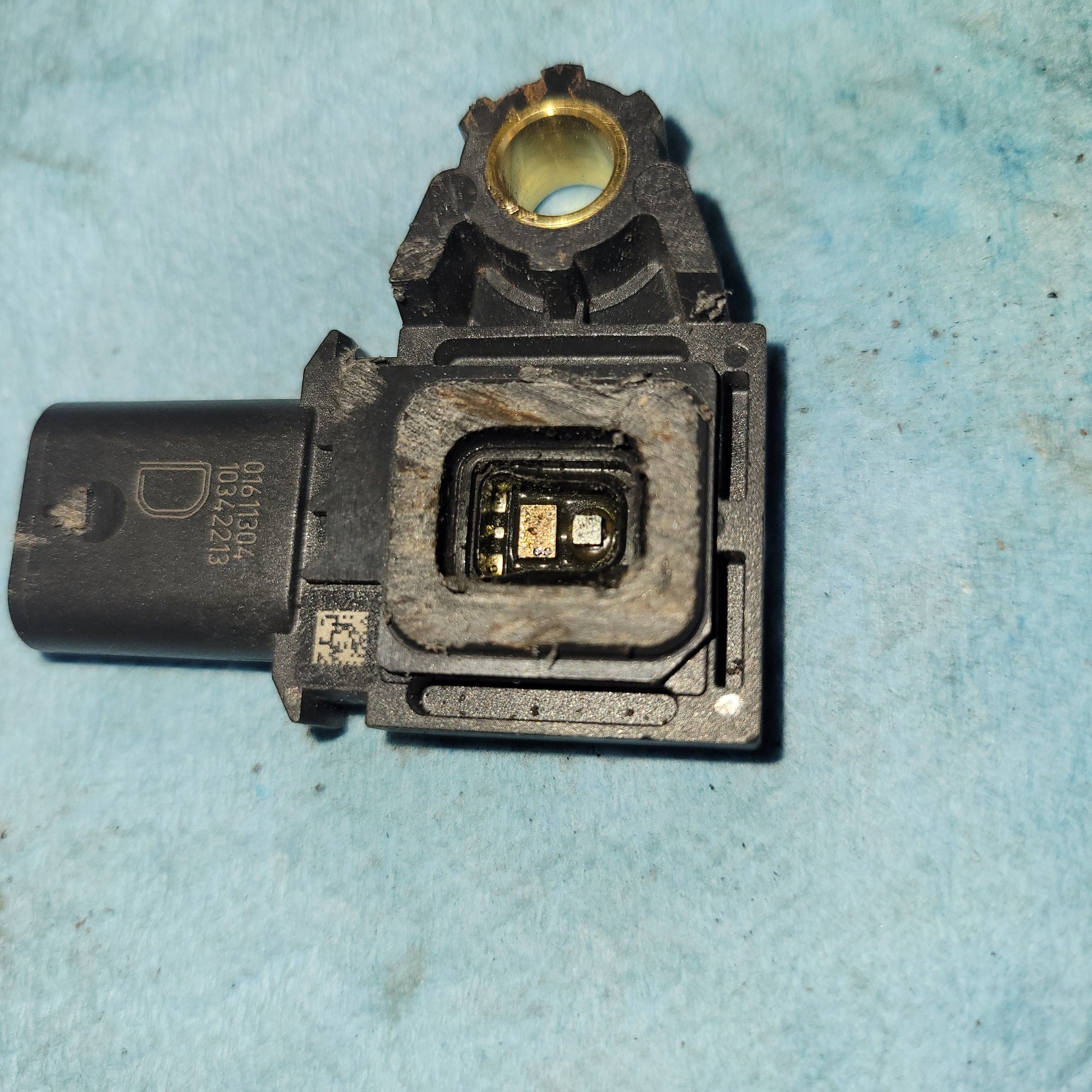

To follow up on my previous post - the MAP sensor did throw three DTC's and went into full failure mode. All three in the PCM - P0105, U0609, and P0069.
I replaced the sensor, cleared the codes and all is well again. The Banks MAP Relocation Kit will be here next week and will get installed immediately since I am now familiar with how easy it is to do.
For reference, this is on a 2022 F-250 6.7L with 40,000 miles. The old sensor was made in Germany 31st week of 2021. The new sensor was made in Czechoslovakia 25th week of 2025. Both are Motorcraft with the same P/N.
In the interest of science, research and helping mankind, I decided to do an autopsy on the failed sensor. I cut the barrel off the failed sensor and immediately found that the plastic shavings from cutting were all stuck inside the remaining part of the sensor in some sort of gooey stuff. That's a technical term for you engineer types out there. I never did see anything that could be considered a membrane unless that was where the gooey stuff came from. Perhaps the membrane dissolved into the gooey stuff. Did the CRC QD Electronics Cleaner do that? I hope not, but really can't say one way or the other. I did twist the corner of a shop rag inside the old sensor while trying to clean it. I never saw anything come out on the rag other than a tiny bit of soot. The only two things that I put inside were the rag tip and the CRC QD Electronics Spray.
The picture below was after I cleaned everything up on the failed sensor.
Old sensor during autopsy.

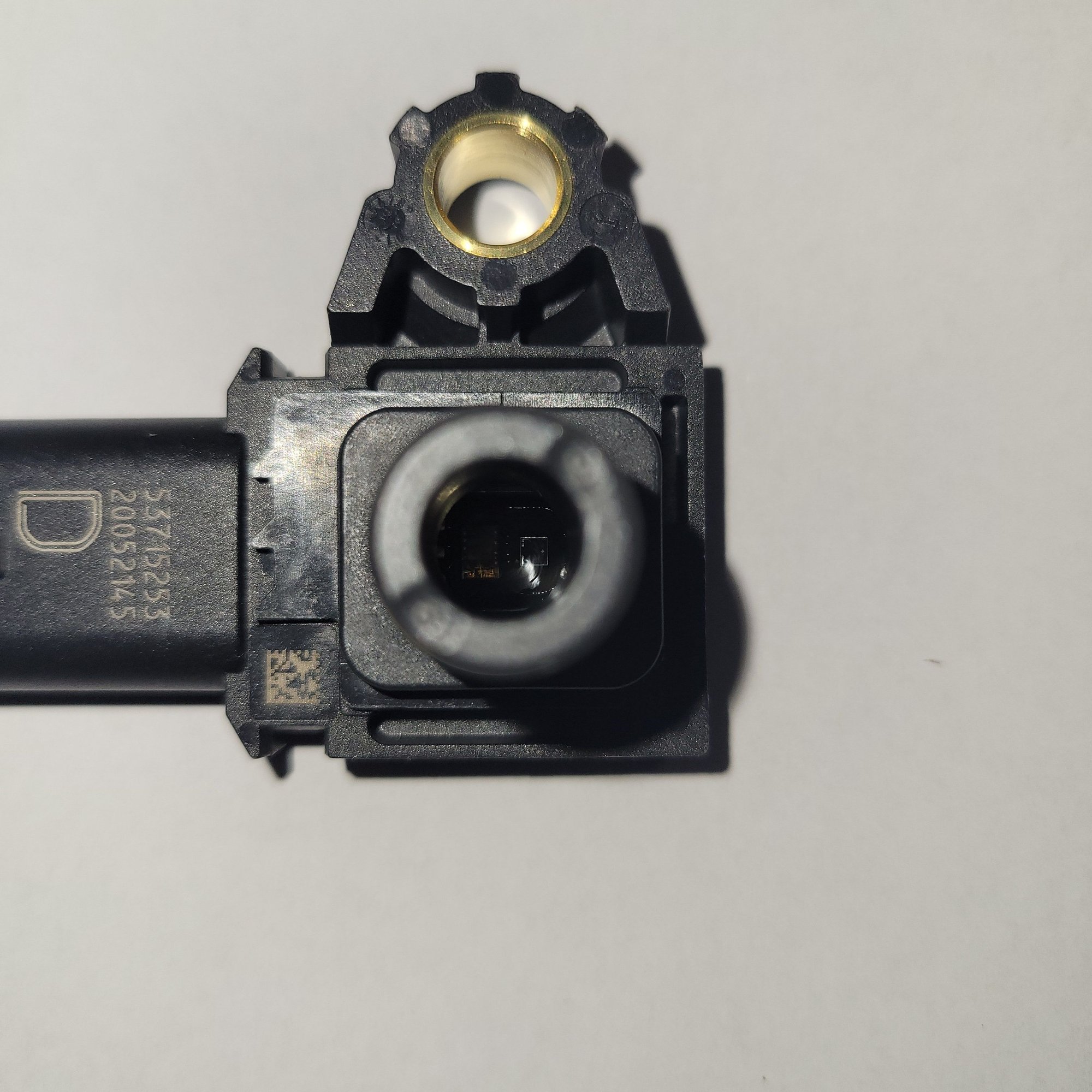

I did a close examination of the new sensor before installing it and I will say the electronics on the inside look different, at least looking through the little hole.
It looks like small components at the bottom center and a + over to the right.
