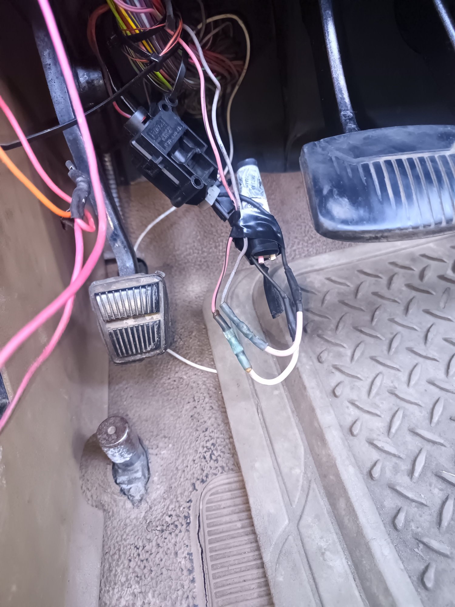

Hey,
1987 F150 4.9. a while ago the truck left me stranded when one of the connectors going to the inertia switch had become so hot, it melted through. Spent a while diagnosing that one
So I cut out that connector and crimp butt spliced where needed. Issue is, the wires are still very warm. I've posted on facebook. Responses vary from a bad fuel link pulling too much current (CO worker has an amp clamp I'll borrow) but I don't know what it's supposed to be pulling. Another response is that maybe the inertia switch is incorrect itself . It has the ability to hold three wires but only two are used.
Can anyone help me find information on these inertia switches and how to test them? The current one has continuity where it should and none when it should not .
Any help and advice is appreciated

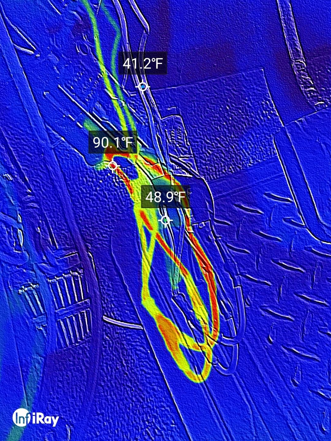

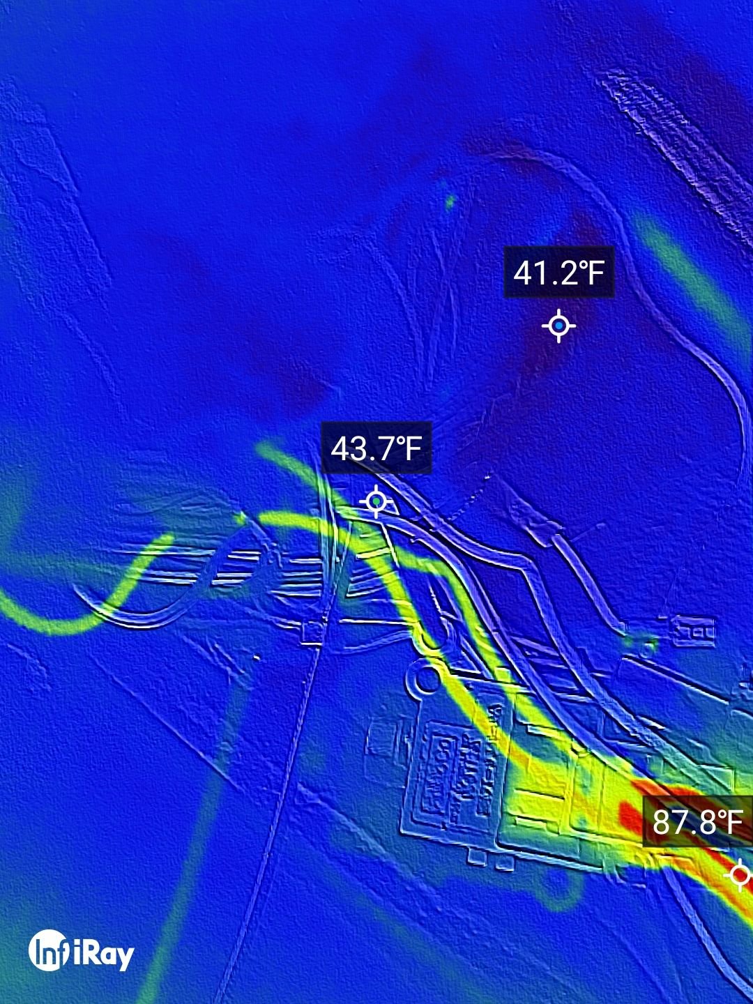

I dont have a good answer but the switch is not showing hot from the IR gun and if it is passing power it would be good.
The wires heating up is the weak link and will burn up again if not fixed.
The only reason I can think of the wires heating out is too high a load draw for wire size or high resistance from corrosion.
High load could be the pump going bad and drawing too much amps.
I would think you could check what the pump draws and then check it to see if within spec.
The other but a WAG is a short in the wire but not blowing the fuse.

I did not think of this before, dont know why? But you could bypass the switch with jumper wires of a larger size that the wires to the switch.
Again I dont think it is the switch as the IR is not showing the switch being hot jut the wires to it from what I can see.
They also say not to let tanks get too low as the fuel keep the pump cool.
Dont know how long that pump has been installed but with the sender acting up it might be time for a pump / sender swap out.

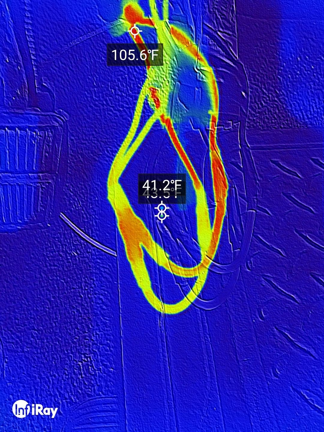

I have no clue how the new power probes work as I dont have or used one so tripping or not means nothing to me sorry to say.
But from what I see from the first link of the wiring. If the wire that gets hot is BR - brown before the switch or PK / BK- pink / black after the switch the only thing I see is the pump and being you have a Fxxx truck and not a Bronco you dont have a resister.
That is telling me the pump is pulling too much power / amps but check it with a meter.

Each wire is hot. The wire on my truck is not BROWN, but GREY/BLACK.

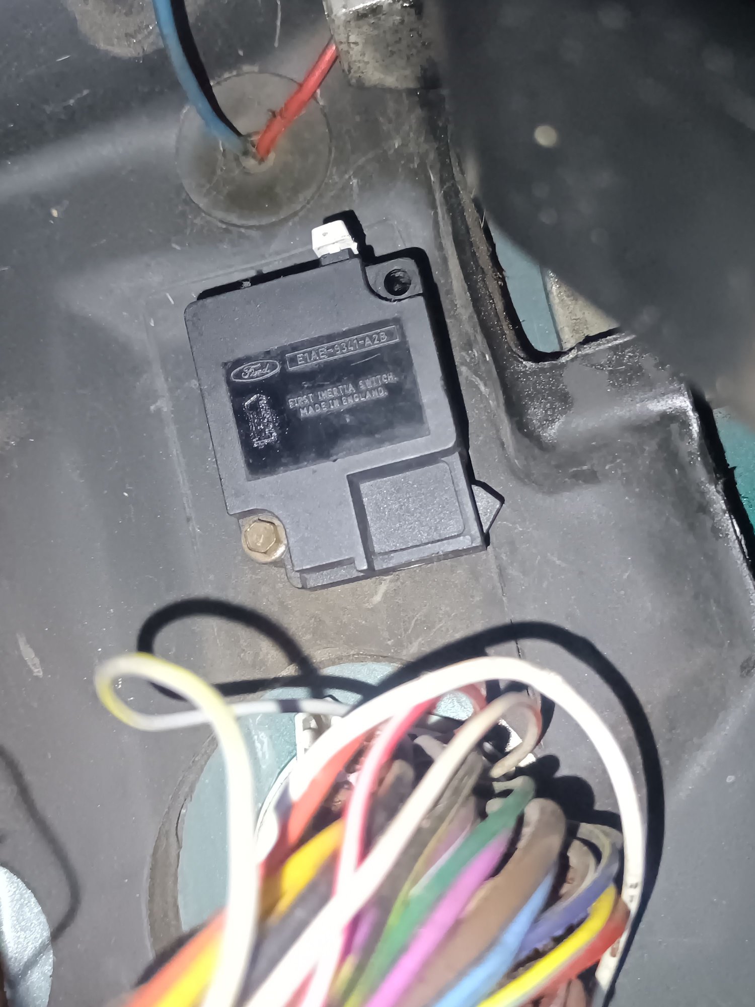

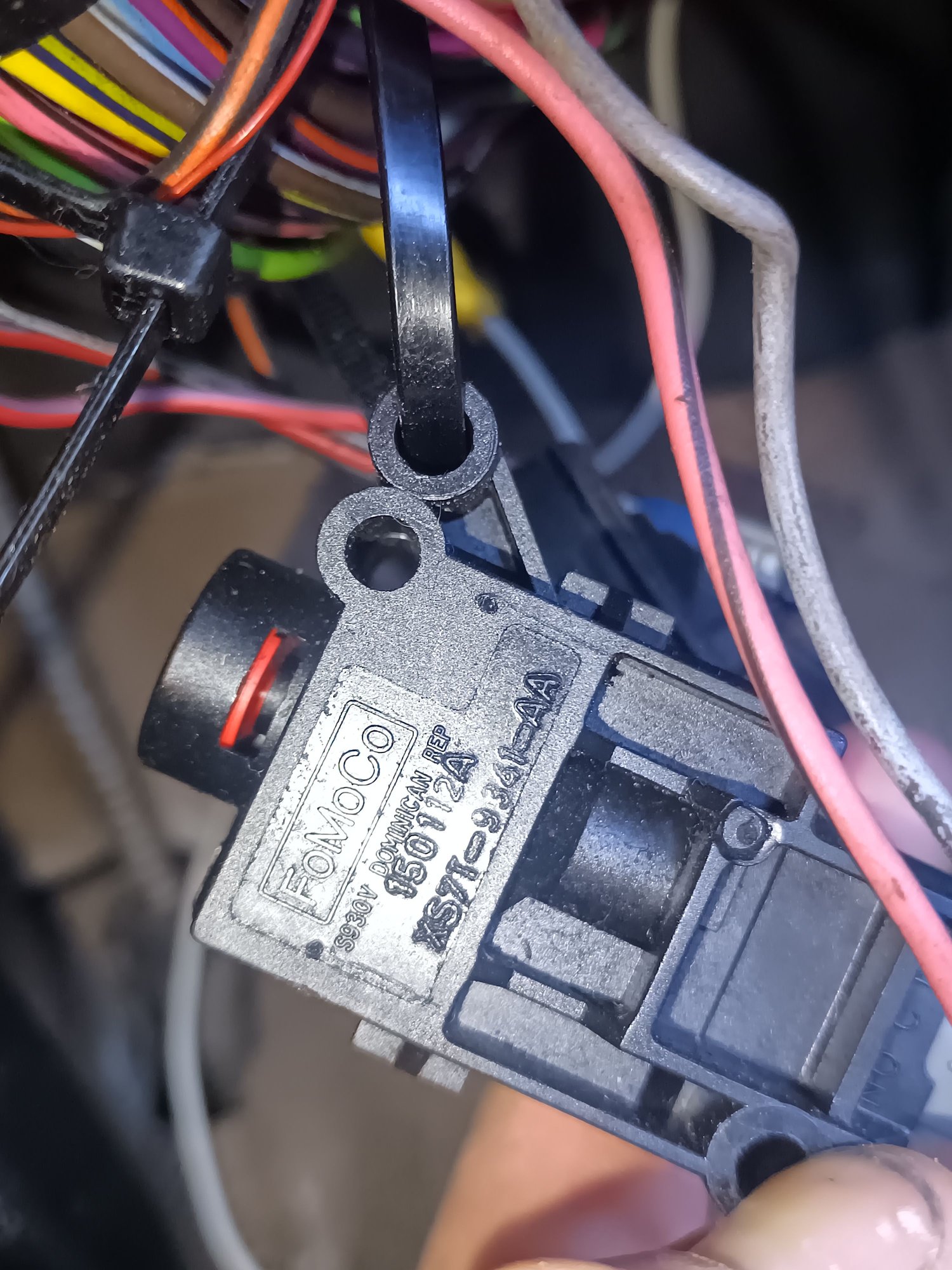

I would inspect the inertia switch itself. As far as I have seen, all inertia switches have a ball bearing and two blades that get connected when the ball bearing falls between the two blades. It is the contact of the ball with the blades that is broken to interrupt power when the ball is jostlied out of position or falls out due to gravity. The reset just pushes the ball back into place where gravity will hold it until it is bumped/rolled out of position.
If the edges of the blades are corroded, you might find the resistance higher than normal which will cause an increase in heat.
It is not unusual for wiring to get warm. Just above hand temperature. Not hot. increased resistance will cause heat, and a festering ball that was not seated tightly could have caused your original damage.
Sometimes just dancing on the red button to jostle the ball bearing around will clean up the contact areas and reduce the resistance and thus minimize the heat generation.
Go dance on the button a few times and then check back.
tom

Jiggled and jostled the ball a handful of times and the wires still get very warm
https://photos.app.goo.gl/6XycbXv2LXJV2YuPA
