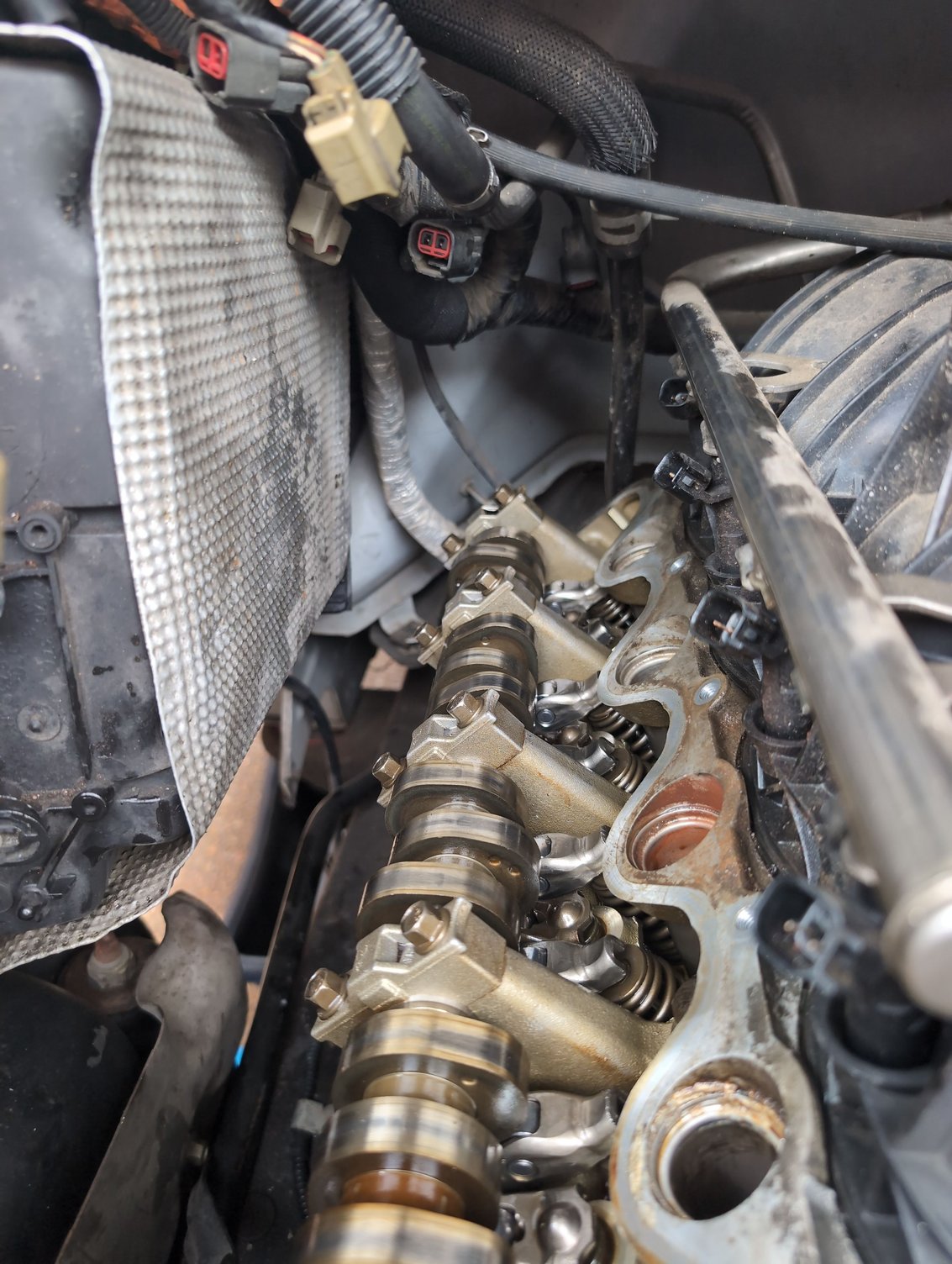

I'm replacing the roller followers on my son's 2005 F250 5.4l 3v. Driver's side went smooth. Passenger side went smooth until I got to the ones next to the evaporator box. The 3 bottom ones don't have enough clearance from the evap box to get the depressor tool in. Will I have to remove the evap box or is there another trick I could use?

I dont see many 3v any more, but from what i remember I think I took the 2v tool and sanded the inside of the fingers till it fit the 3v.. Also, You have water intrusion on #2 cylinder spark plug tube. I would suggest finding/fixing the water leak..

Thanks...I thought Monroe's reply seemed odd. I ended up emailing Brian(FordTechMakuloko) and he suggested slowly loosening the cam caps until I could sneak them out of there. That worked perfectly. Got everything out back together and now trying to troubleshoot a lean condition code. I'm thinking I have a vacuum leak somewhere.
