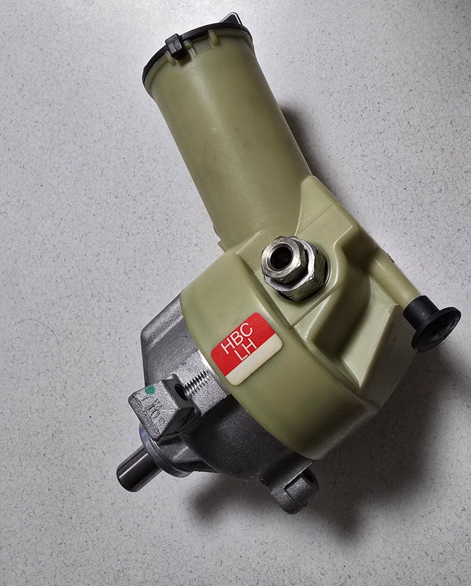

Ford makes a good pump
Look for NOS Ford on Ebay
The NEW ford pumps were around 380 way back
Here is my spare I bought as I walked away from the dealer in 2000
Note the quick connect line and the new cap on the new pumps
I still buy the 58 dollar ones for clients, and every once in a while, I get a good one
