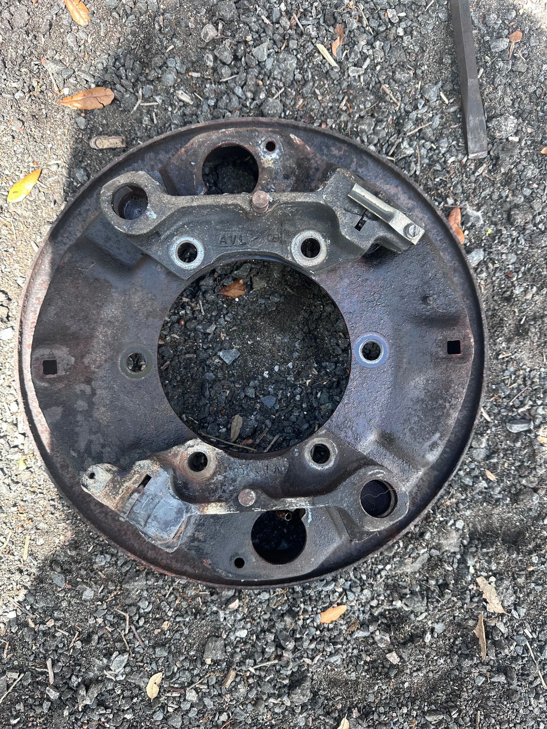

Going to need a miracle !! One of my shoe adjusters was completely frozen on the bottom passenger side .. i spent 2 days trying to free it with no luck and thought i could pull the bracket assembly off the backer but they were either frozen or riveted from factory not to come apart from the backer .
would anyone have a backing plate with two working adjuster mechanism?? I will attach a photo of mine .

That's going to be tough, because they are handed (L/R) and specific to the 7" shoe width.
