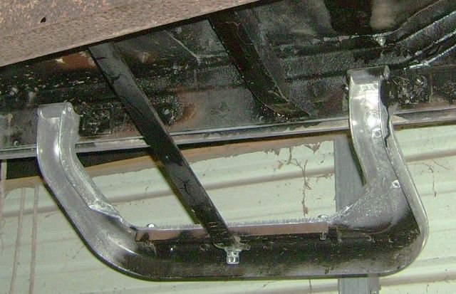

I gave a lot of thought to the twisting force of me stepping on / off a step bolted to that rocker hanging down. I arrived at a solution, I only used one bolt through the step to the step brackets (I made at each of 4 places). This meant the steps would be free to swing in and the rocker was only holding them up off the ground. Then I used 1-1/2" x 1/4" steel to make "struts" to hold those steps outward & level. That steel bolts to a piece under the step that goes crossways to spread the load. The other end of the brace bolts to the floor over above the frame, with big washers. I used "Carr" Super Hoops 124032.
I made my hanger brackets heavier duty.
I know it could use some detail work.
Hope it helps.......................

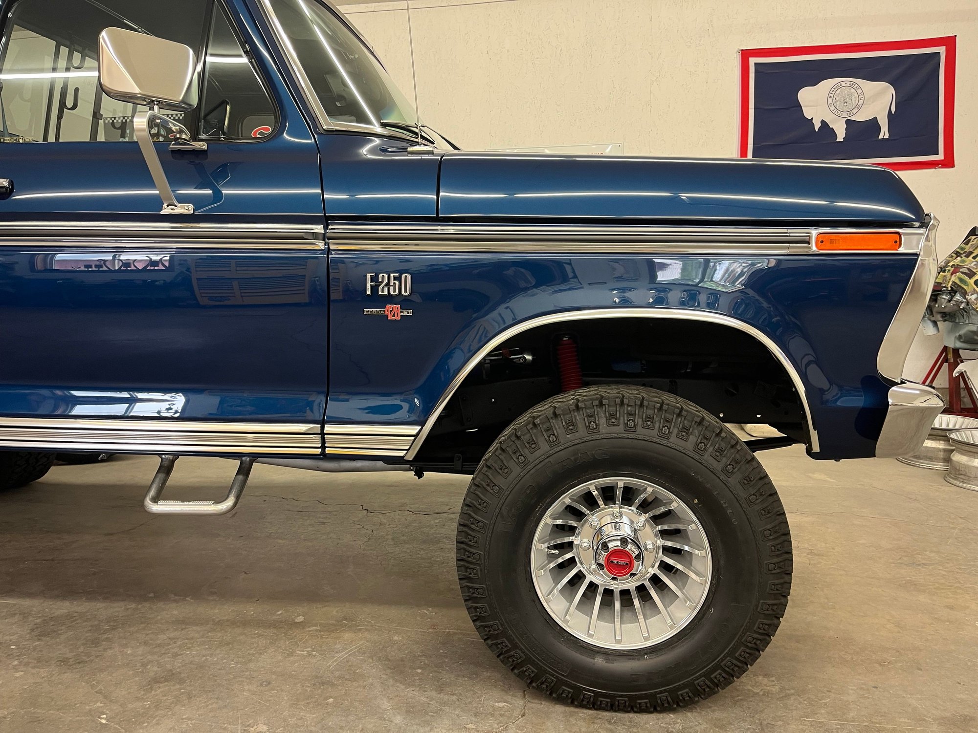

These steps have been on my pickup for many years and the metal on the cab has no cracks or bending. no need for alterations.

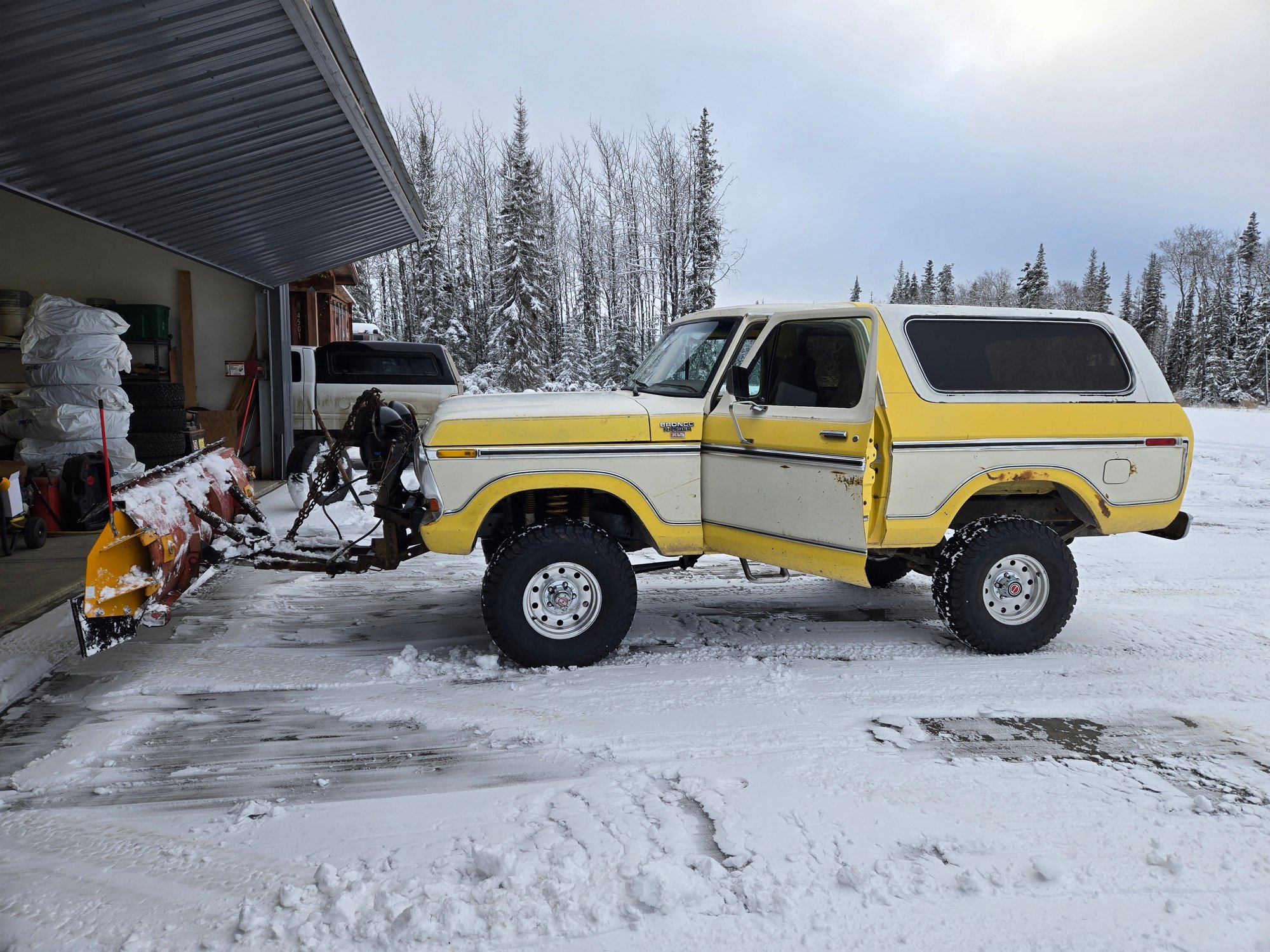

Ive put the Carr hoops on my 75 f250 and 78 bronco. Looks like about the same as 440 six-pack install
