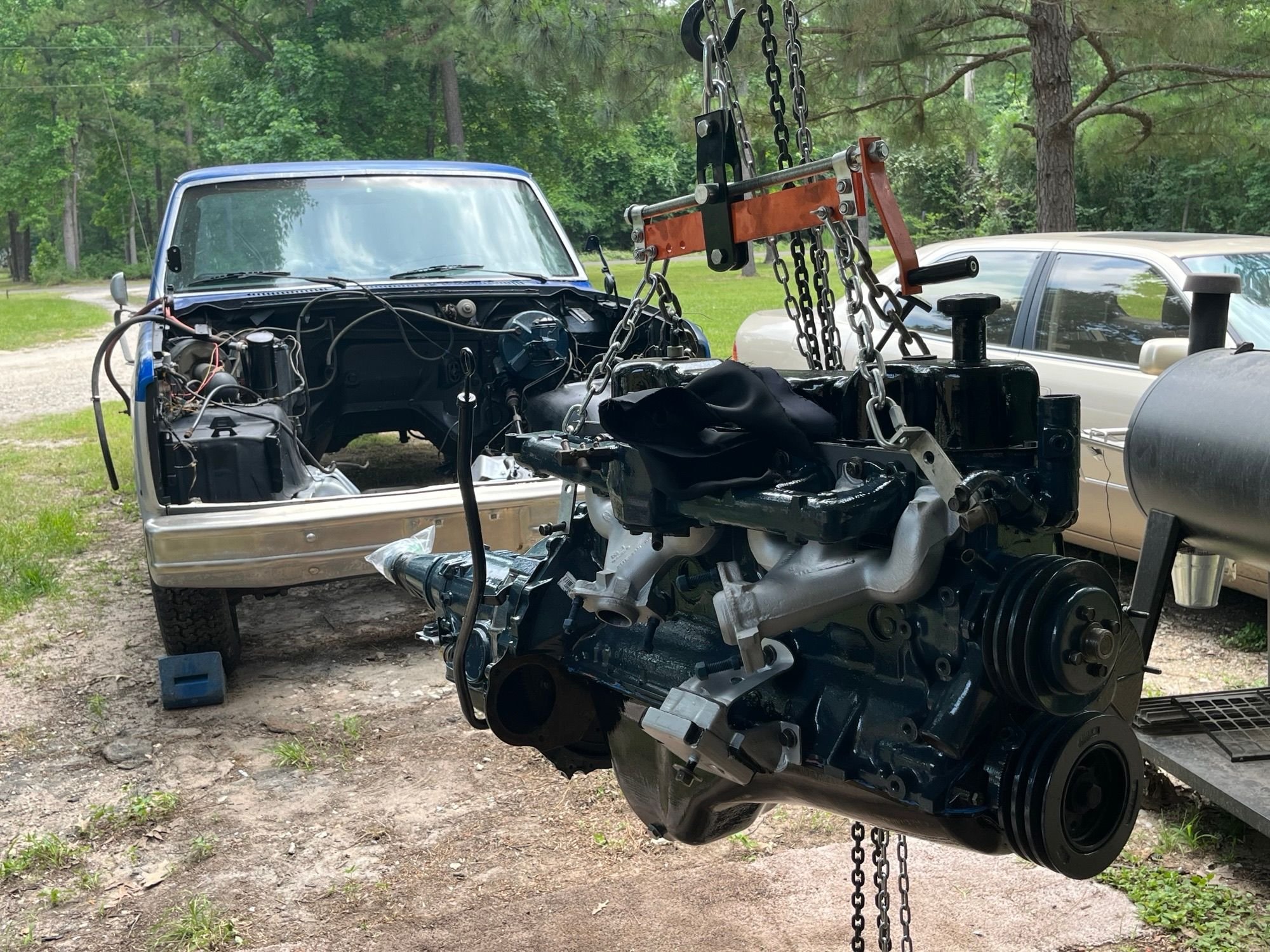

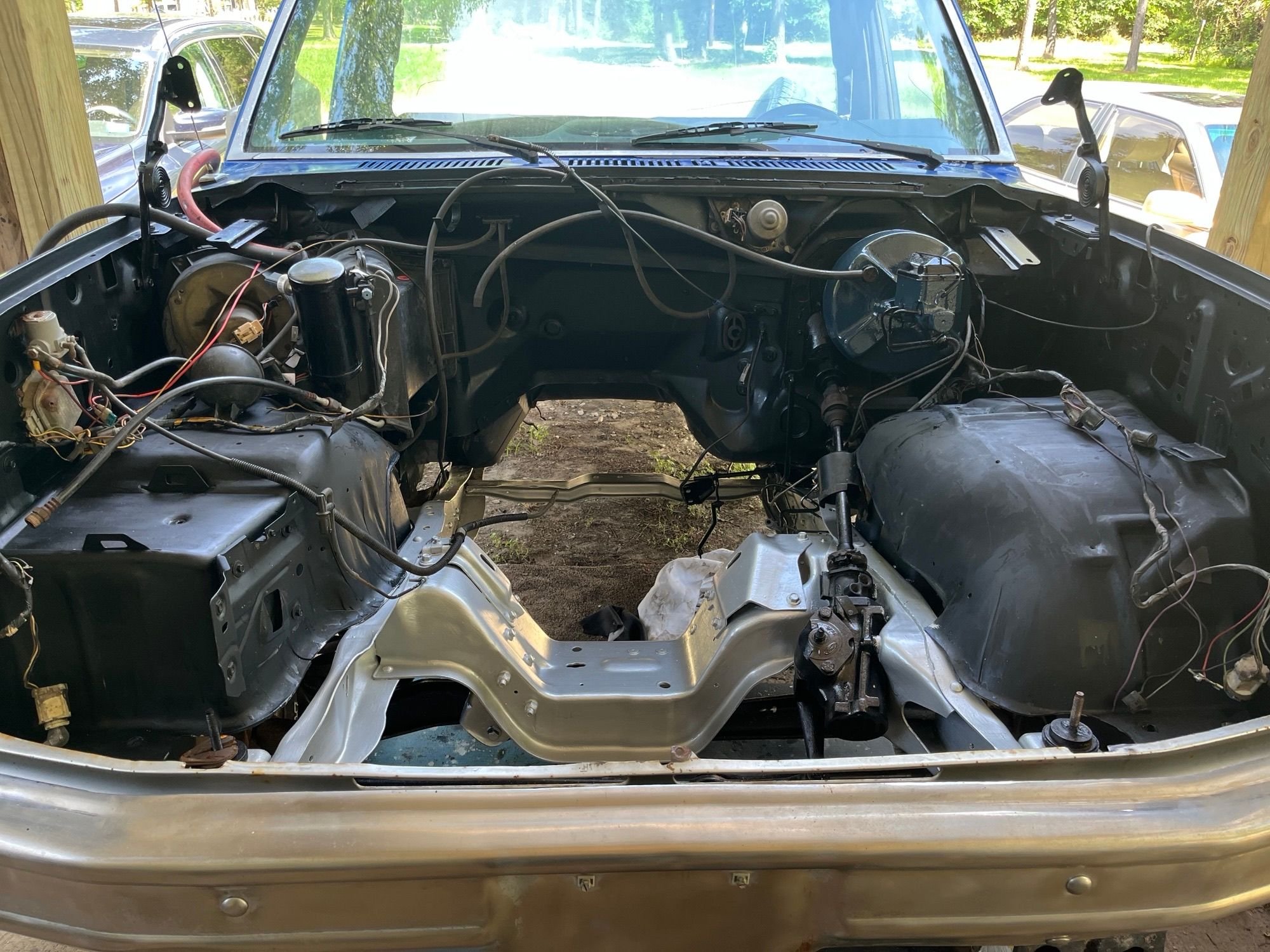

i did not need to remove the fenders when pulling my 300. But i did find it much easier with the radiator support out also. It only takes a few more hours to remove. And made the pull much easier.
engine compartment ready.
time to stab the motor in

I had considered that, but I am also overhauling the suspension and removing the clip exposes everything. "a few more hours" I figured timewise it is a wash between removing the whole thing or just the rad support.
Thanks for the pics, your ride is super clean there.
Thanks that was a few weekends with a wire wheel, some rust converter and rustoleum paint! Just hoping to keep it on the road another 40years or so!
