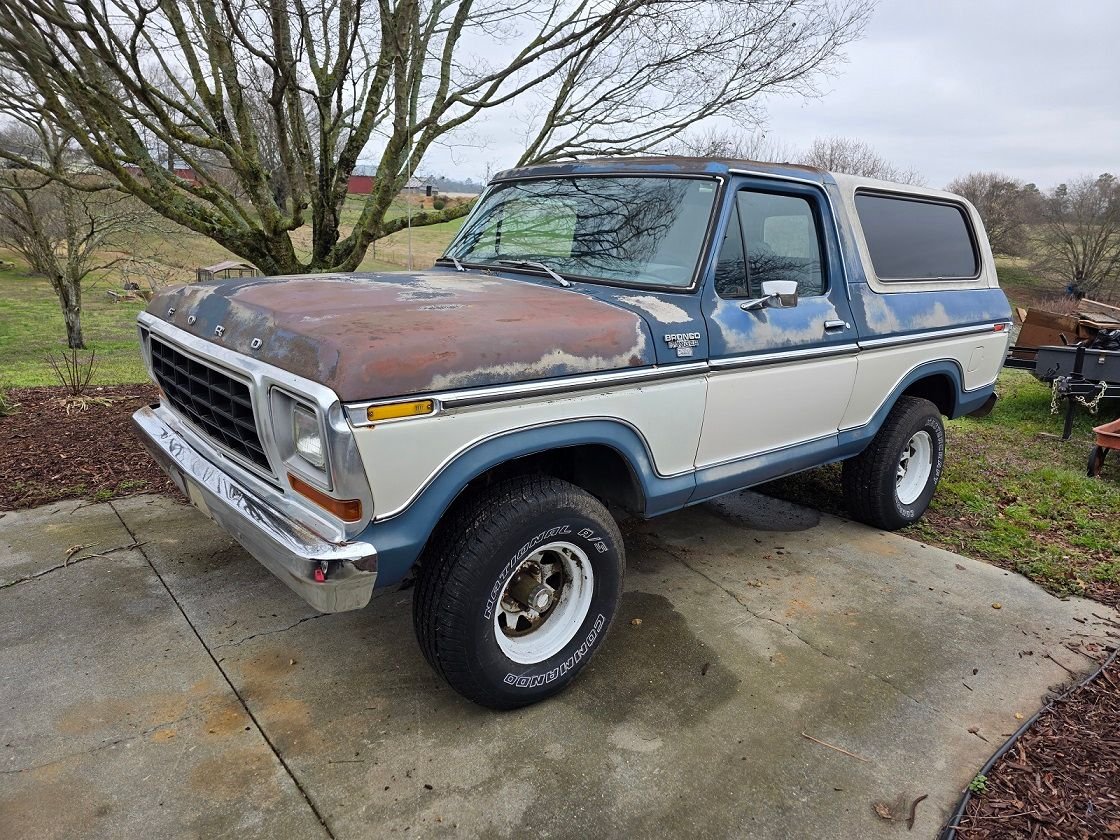

New Toy
Just picked this up yesterday. '79 Bronco Ranger XLT with 118k miles and one owner. It has a 351M and auto trans. I drove it home but it needs some work to make a road worthy. Other than LMC, where are yall shopping for parts?

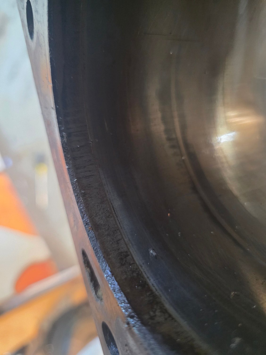

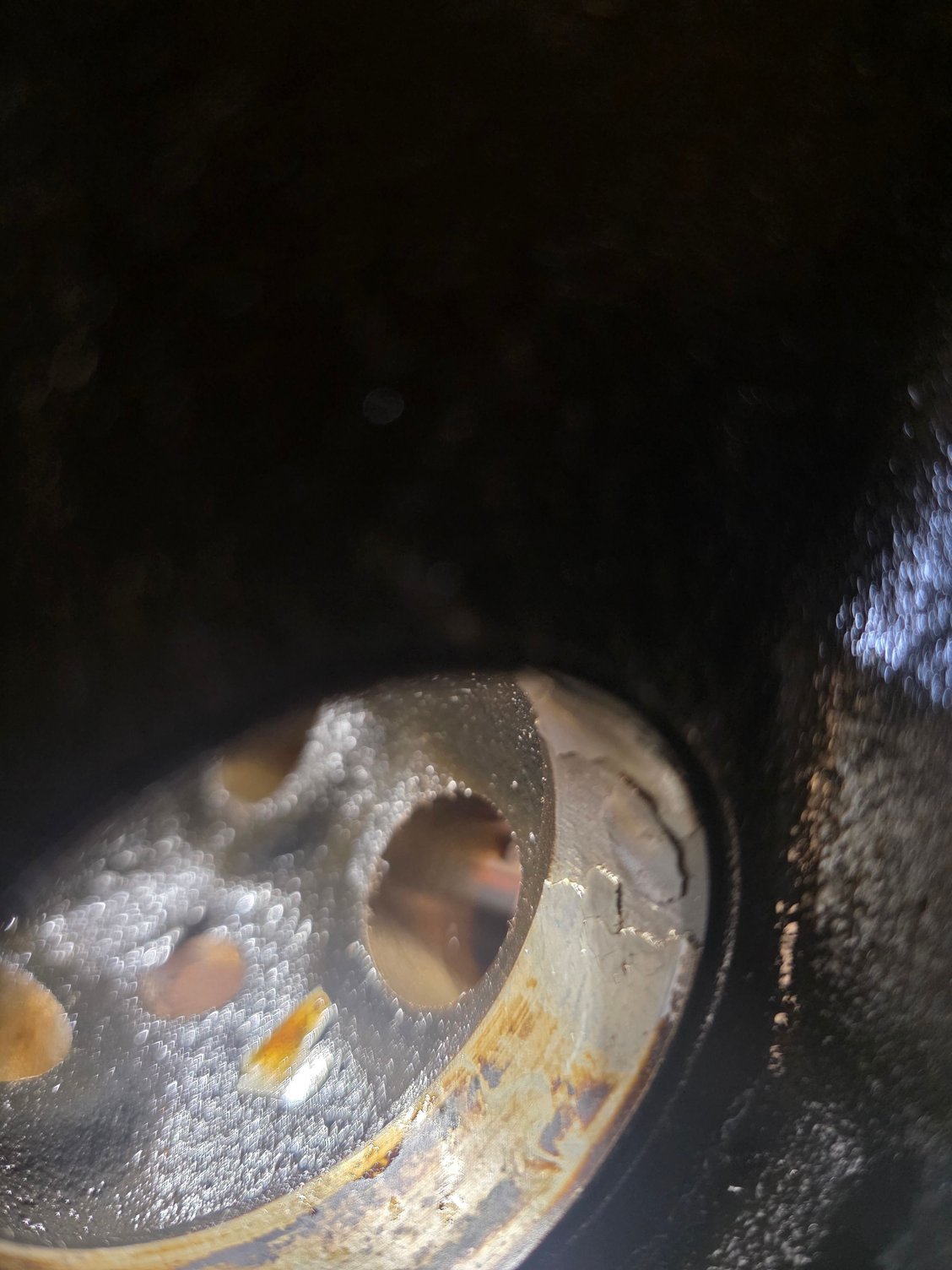

Finally got a chance to pull the motor, my youngest son helped. The ring groove is a bit excessive, and the cam bearings look horrible.
Main and rod journals look ok, but I'll be sending the block, crank and heads to the machine shop to have everything checked before I buy any parts.
