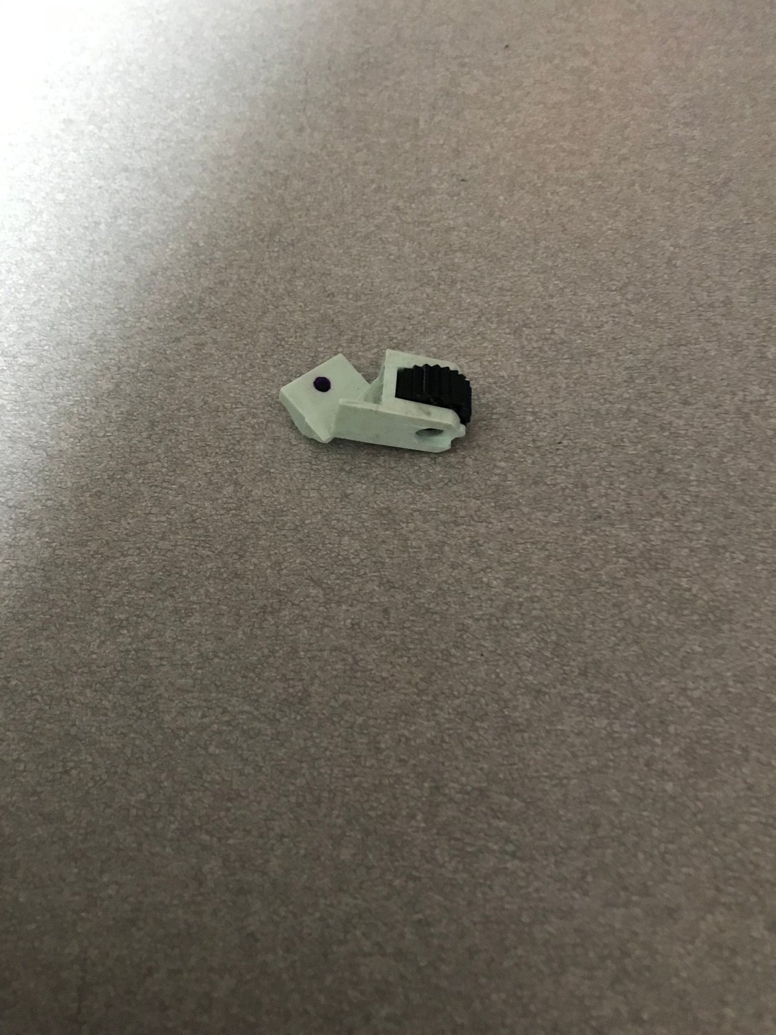

Looking for Part # - Shift Cable Thumbwheel Bracket
I don't know if this exists as a separate part or if I have to buy it as part of the shifter cable. I looked under my steering wheel to adjust a misaligned needle on the dash. I found the thumbwheel bracket broken. I've been trying to search for a part number but can't locate one. Any leads on where to look would be greatly appreciated. I slipped it off the threads of the cable and took a picture for reference. Off a 2004 6.0 Excursion. Thanks for reading!

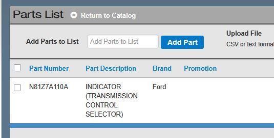

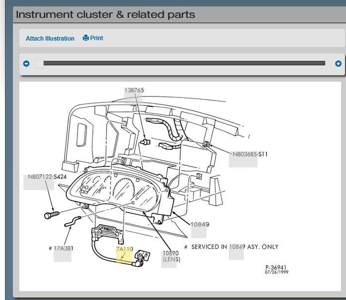

Old Feb 25, 2026 | 03:32 PM
01__Excursion's Avatar
01__Excursion
Joined: Nov 2017
Posts: 3,096
Likes: 534
From: Rock Hill, SC
Old Feb 25, 2026 | 07:35 PM
Don Ridley's Avatar
Don Ridley
Joined: Jan 2023
Posts: 1,318
Likes: 446
This is an aftermarket option.

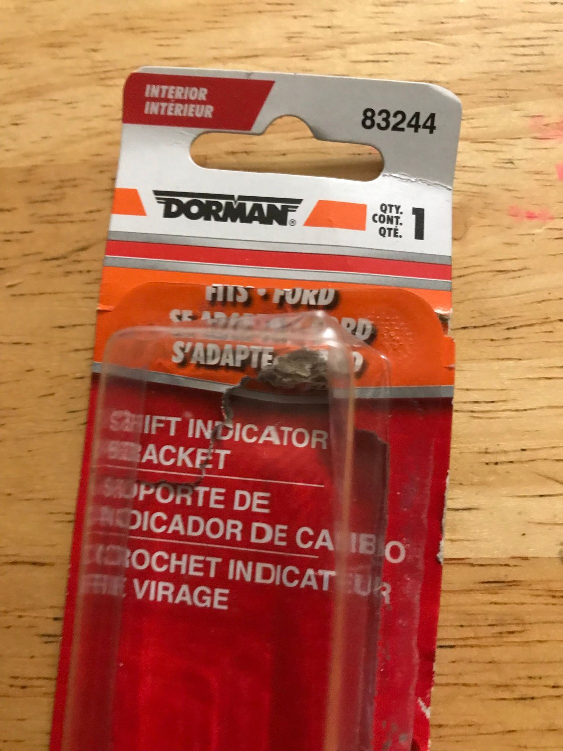

I was able to take the picture of the whole assembly with me to the parts store. They didn't carry the whole selector unit, but the guy behind the counter has a Ranger and knew exactly what I was after. Had it in stock, and now I'm back in business with a shifter that moves and works correctly.
Thanks!

If the whole selector unit I posted above is only avail as the entire assy, what part did he have in stock? Post the part number.
Old Mar 1, 2026 | 08:55 PM
hammondpipe's Avatar
hammondpipe
Joined: Feb 2020
Posts: 84
Likes: 10
From: Southern Illinois
Here it is!
