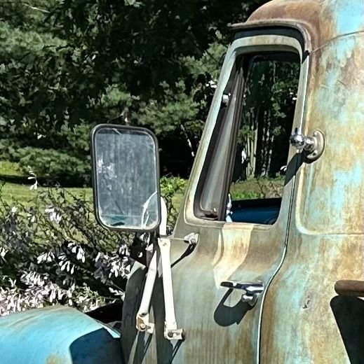

I want to get replacement glass for my side mirrors as they match the aged look of the truck as opposed to the fresh chrome ones I have on there now. I went to a local glass store and they said special automotive mirror glass has to be used.
I have searched online to get replacements made. Due to the age there is not standard replacement. Any suggestions on where I can send them out to get replaced.

FYI - Those mirrors are not factory original. I wouldn't go crazy trying to "repair" the heads. Don't like the chrome? Paint and distress accordingly.

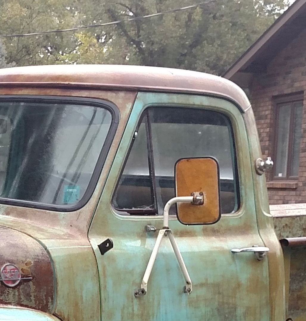

I have new chrome mirrors with the original mounts in place. I was trying to avoid having to weather them. The trick is getting the rust to bleed into the paint as well as create that speckled pitted rust pop through the paint look as opposed to just patches of rust. The cream colored paint should be easy to duplicate.
I think the mirrors I bought might be stainless steel...D'oh! So I would need to get some steel ones to get them to weather.
if I can find a glass place that is definitely the preference but if not good idea on weathering a set.
