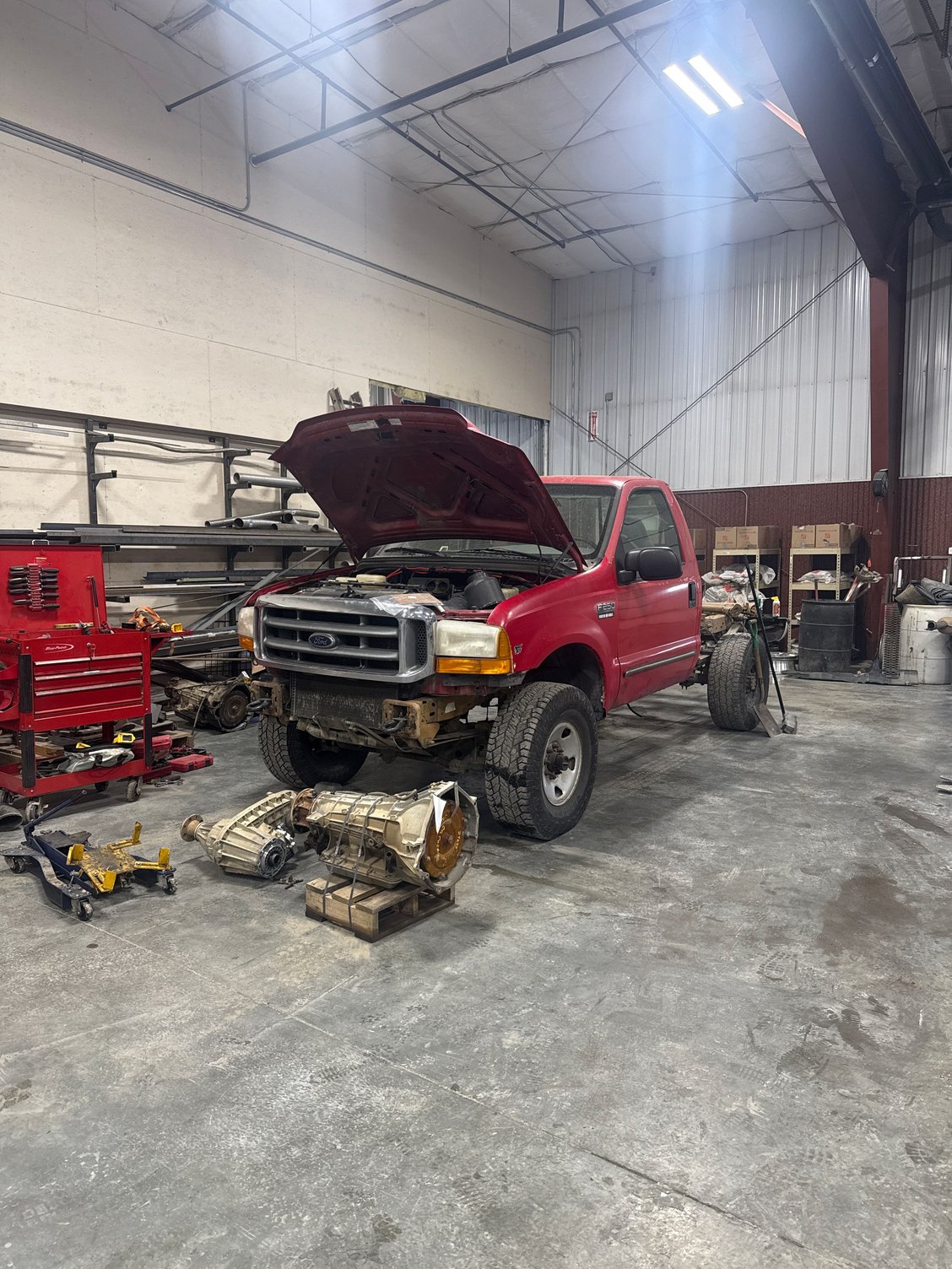

So got the transfer case and transmission out this morning, new shift motor on the t-case new front pump seal to go in next on the new to me trans. Then it’s getting back in. I’ll be posting my cost list in a little bit. And my plan all wrote out. We will see how this all works out.

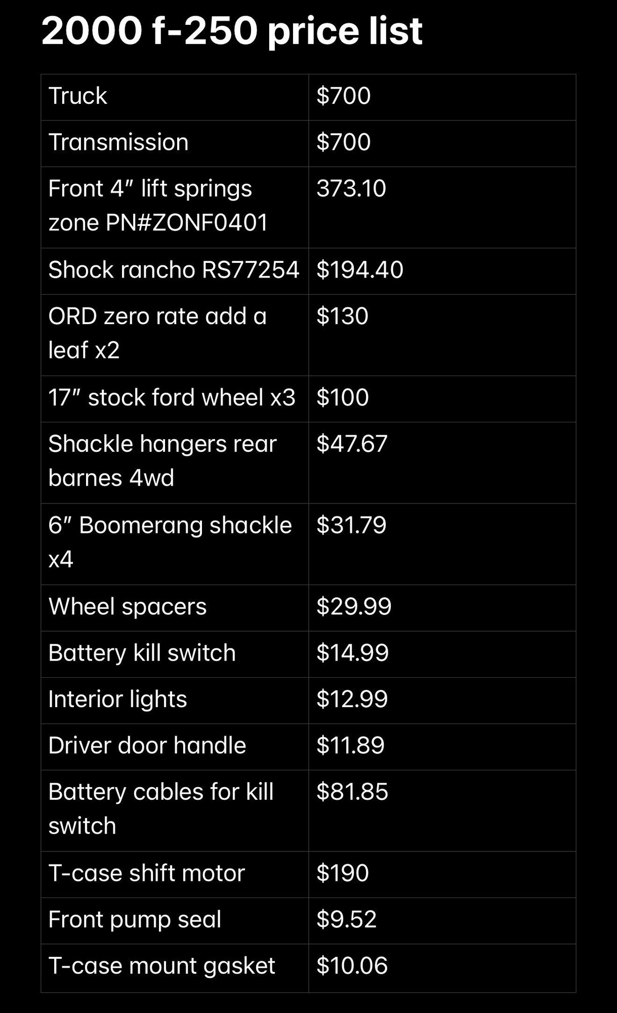

Here’s the current price list for the truck I’ll be adding to this as time goes on.

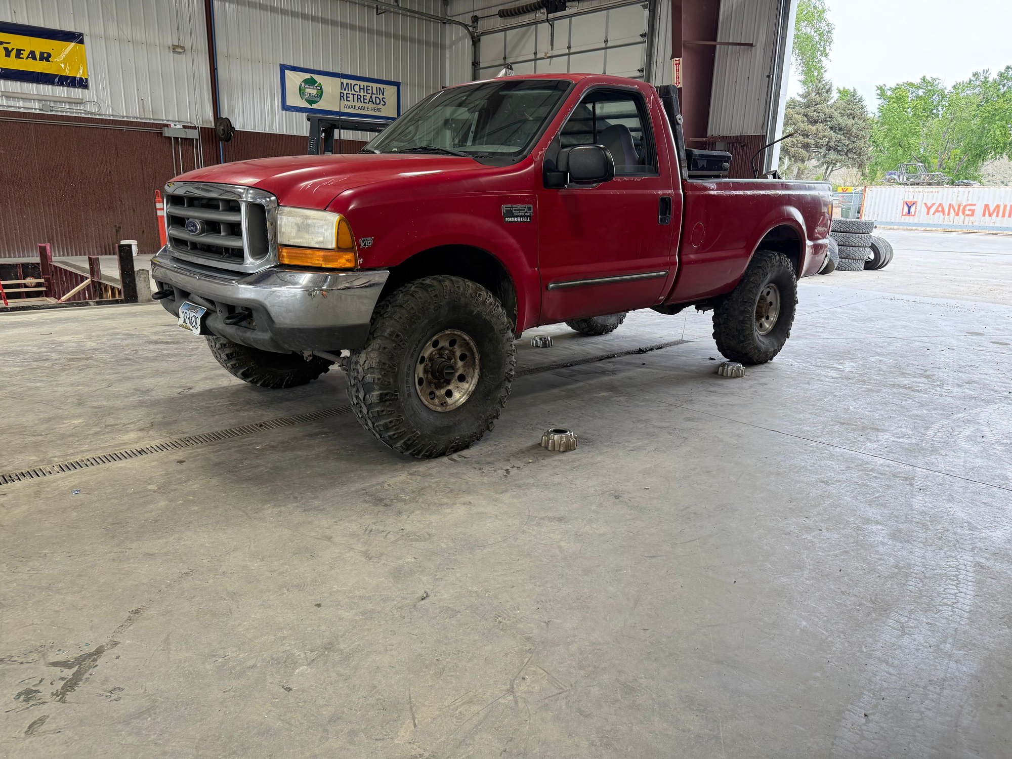

This is how she sits at the end of this Saturday. Might come in the shop tomorrow and try to get the trans in so I can start a mount for it. Also I only get a hour or so a day to work on it so it’s gonna be dragged out for a little bit. But hope to get a big chunk done before April so I can do some testing come spring.

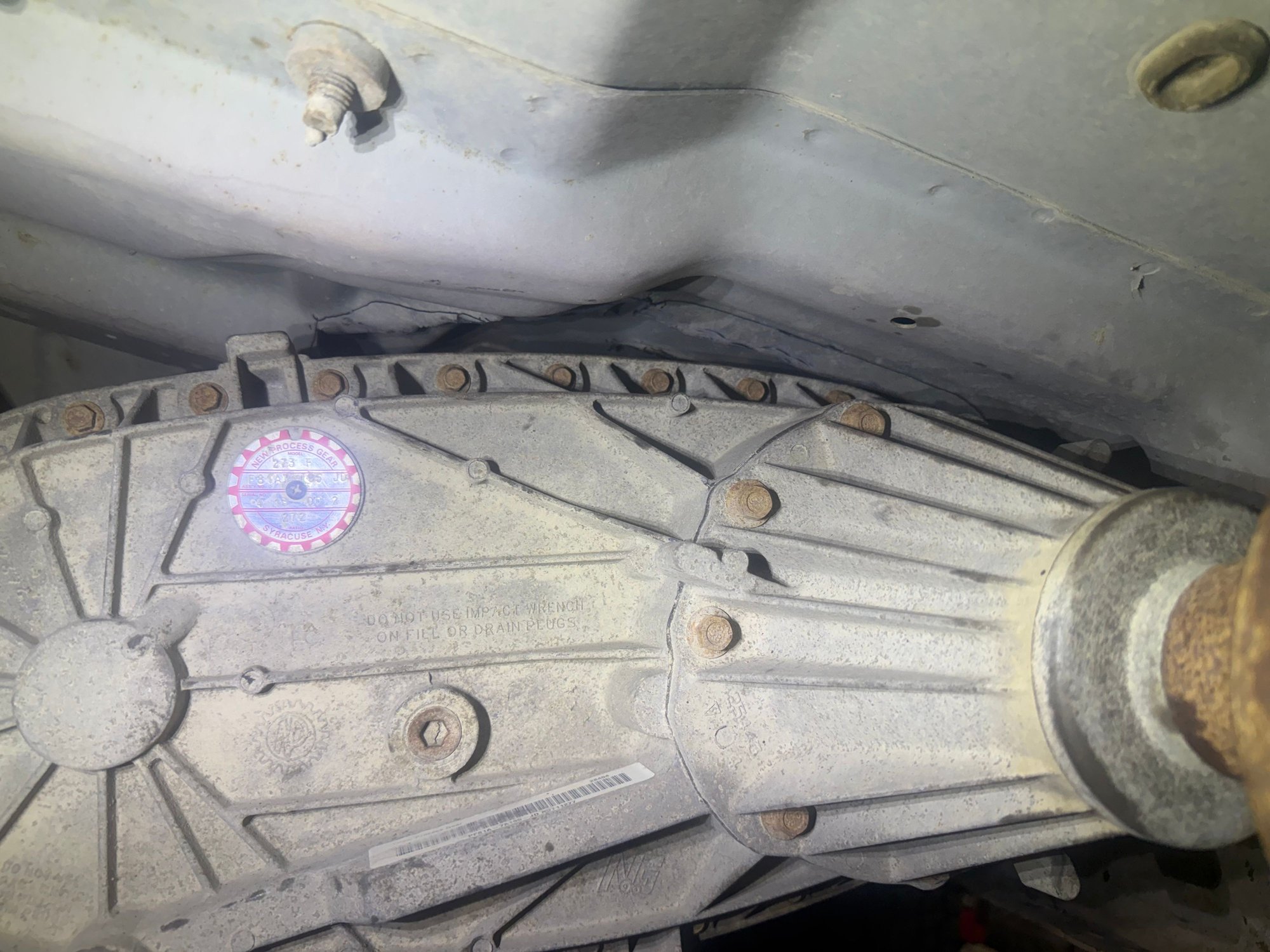

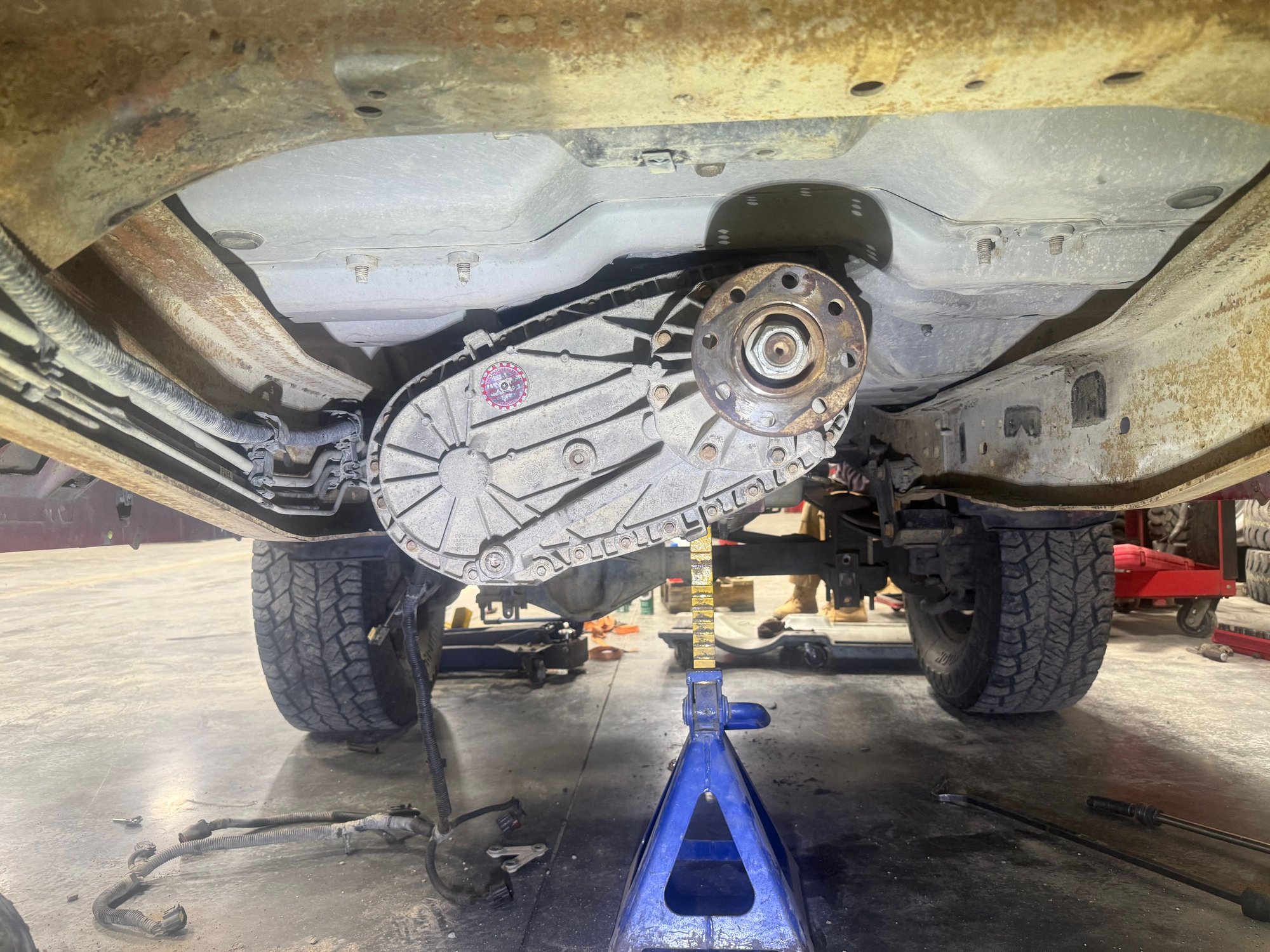

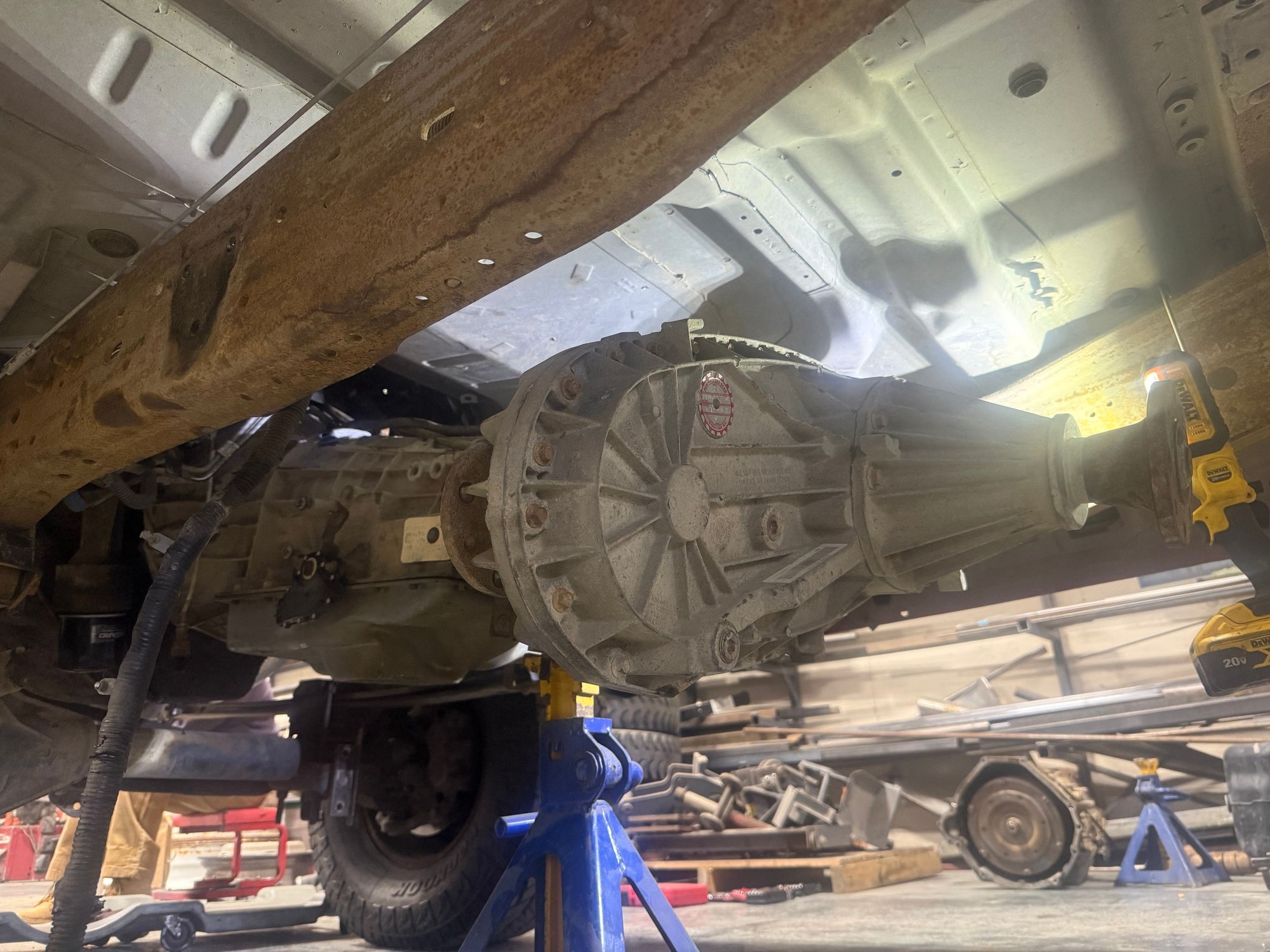

Me and the girl got the front pump seal replaced and the trans and t-case bolted up!

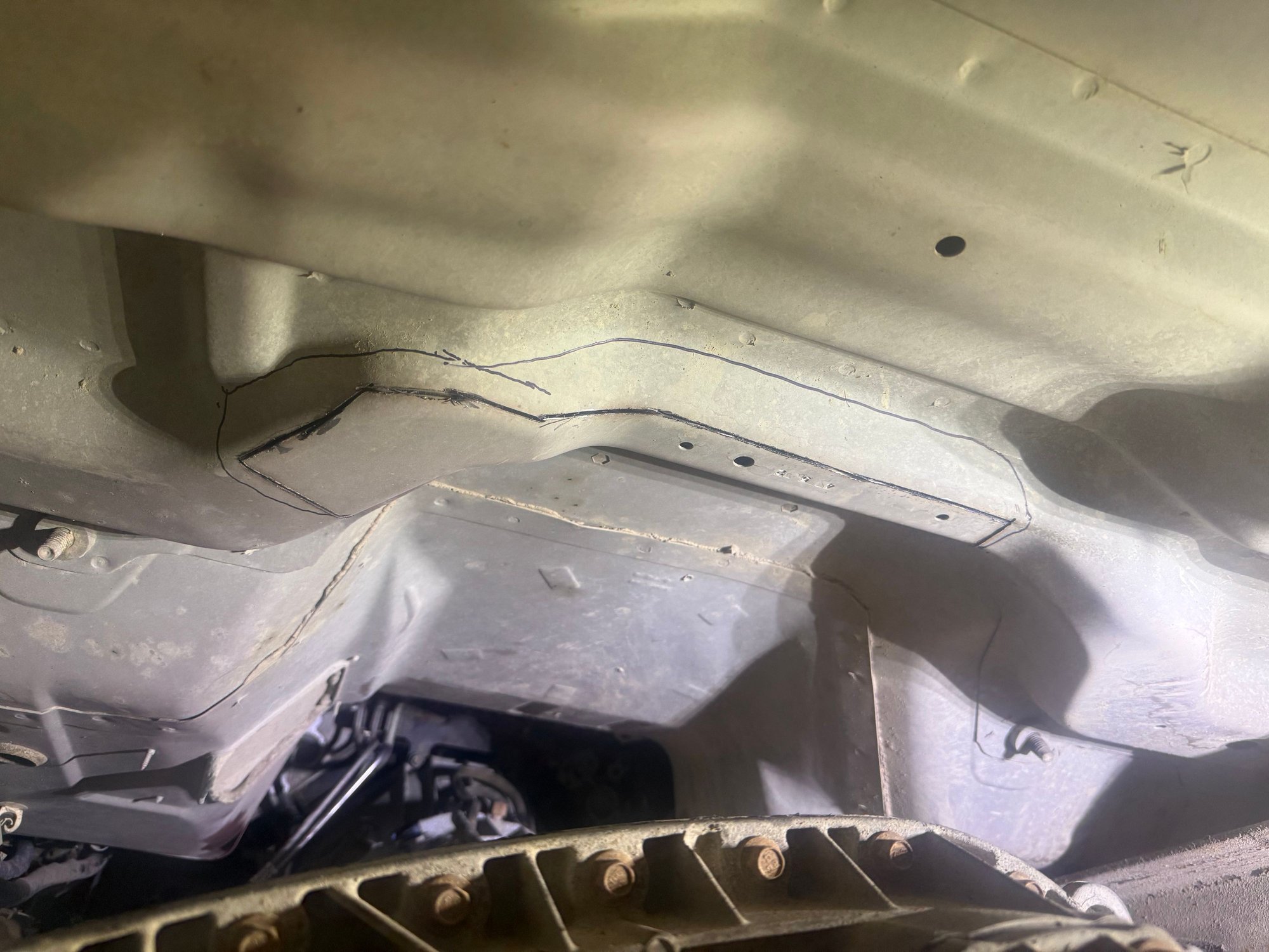

Found a little room to make the belly height a little higher.

Made about an inch of clearance. Cut it out with a grinder and persuaded it with a sledge.
Some numbers before I mess with the suspension and chopping frame off. Bottom of t-case to floor 19.5” Frame at t-case to floor 22” Frame at front body mount 23 7/8”
