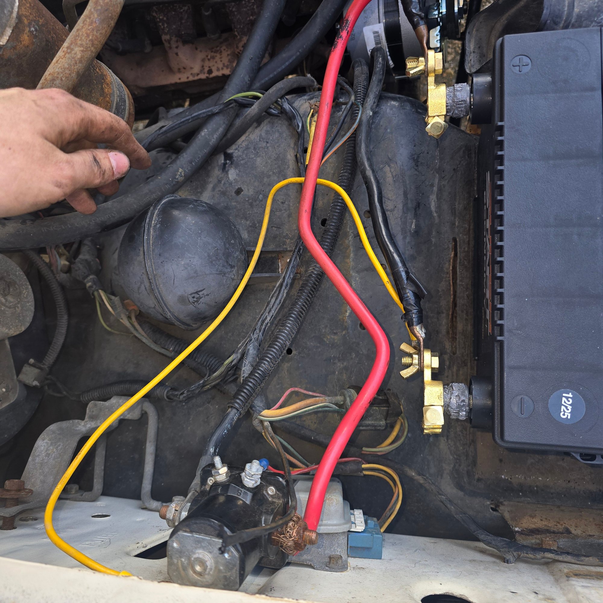

Can you get a better picture of your first photo, showing where that red + cable is going ?

You will need a meter. First thing to check, with the key off engine off, do you have 12v on that large bolt terminal on the back of the alternator? Looking at your wiring at the battery, I am betting not but lets see what you get.

He has a battery in it for a GM vehicle. That is why the cables are so weird.
Oh Dave that end is ok with me but look at the solenoid / starter relay
That looks all wrong to me
Oh I also see a voltage regulator so if that is bad it will not let the ALT charge the battery and can even kill a new ALT and why you should replace them both at the same time.

And those horrible battery cables.

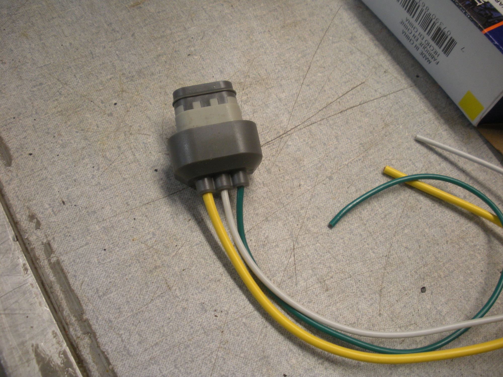

I was looking back over the OP pictures and is that a G1 ALT with the regulator on the inner fender?
IIRC Max you said in a post that the new plug you got or the 2G ALT comes with an internal regulator?

The battery connections need to be explained. That isn't going anywhere fast IMHO. Looks like regular tapered lead posts screwed to the GM style battery and then the cable ends over those screwed on tapered lead posts. It's just so wrong.
