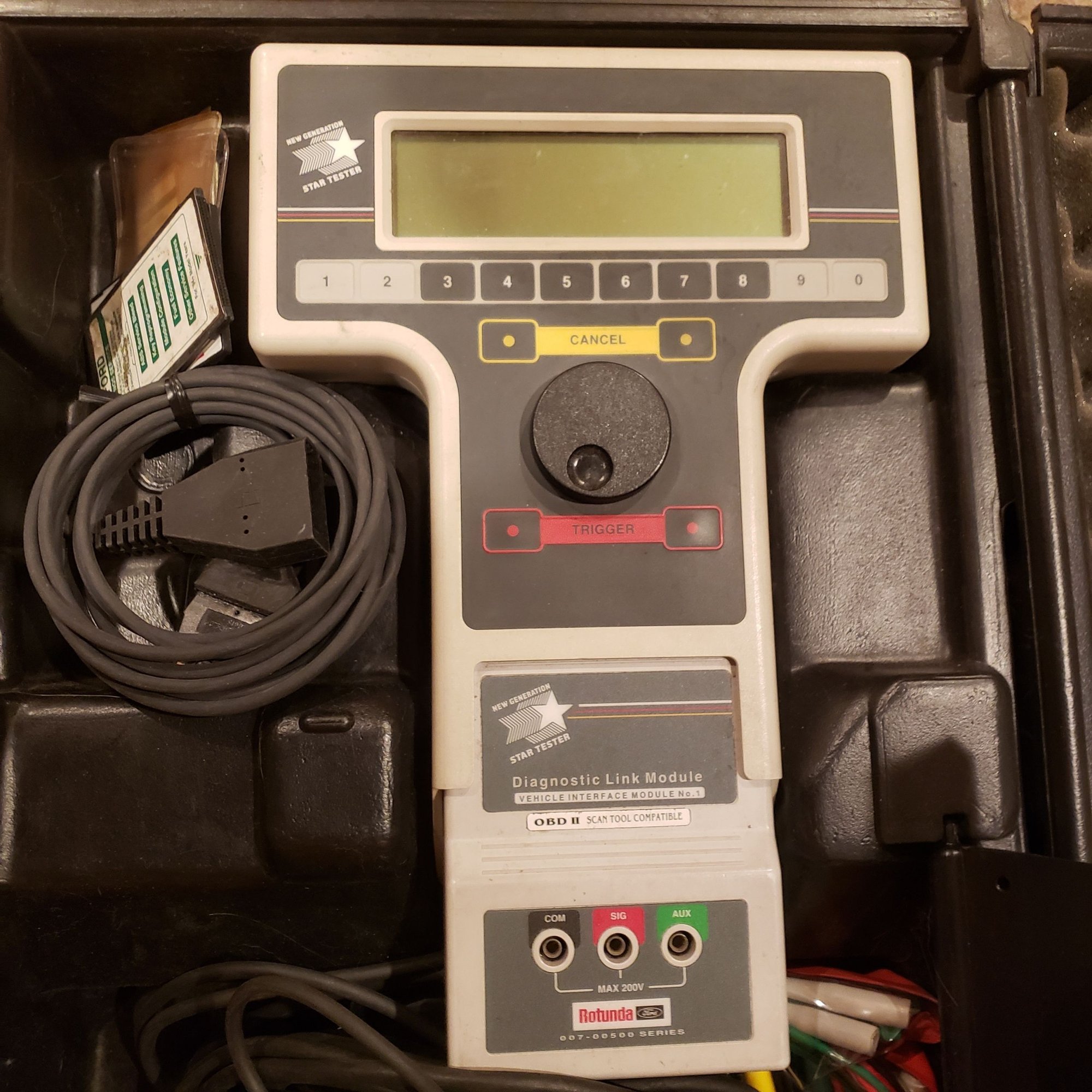

Others will work (partially)
But
This is your Ford scan tool for 1996 and will run about 20 PIDS on that E4OD
