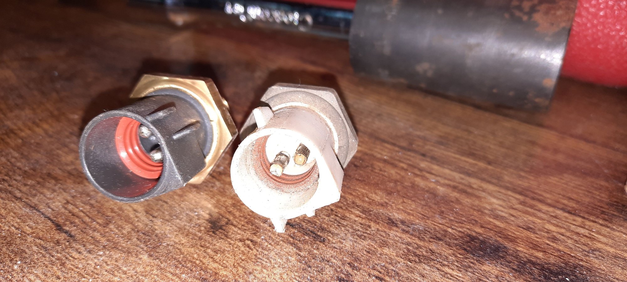

The iat sensor was incorrect due to orientation of plug. Cleaned all the gunk off the old one and reinstalled.

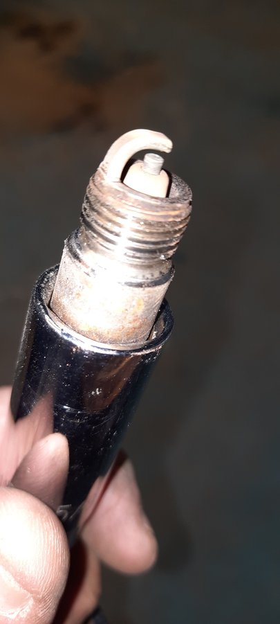

Started pulling plugs to see what they looked like. Could not be more perfect imo.

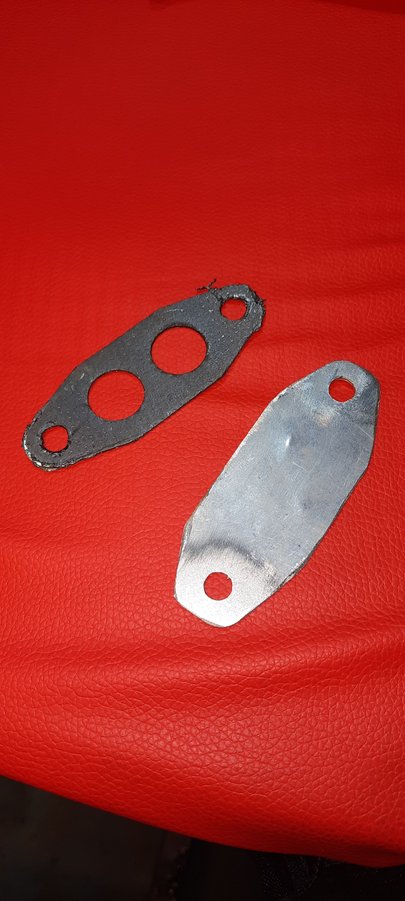

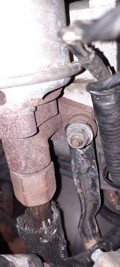

Looked for vac leaks. Was about to give up when idle changed around the egr. Found the mounting flange broken. Made a temporary block off and put it back together.

Contuined further on the replacent of sensors. Have done them one by one to see what makes the most difference. Cleaning the iat, little better, replacing cap and rotor, no change. Fixing vac leak at the egr which was broken by sliding a piece of al between the gasket and egr was a big improvement. Dialed in the timing sweet spot was 26 to 27 degrees on my HB which can't be real advance was a big improvement. Replacing the idle control, no change. Replacing the tps was a big change. Replacing 02 sensor seemed to improve things, but wont know for a new tank of fuel. Waiting on map and correct capacitors to get here for the ecm.
