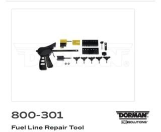

You can buy the nylon fuel line in bulk on Amazon. Be sure to get the Dorman tool that presses the line onto the fittings as well.

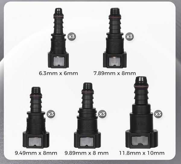

Does these newer style fittings...
Replace these older style fittings? I though the older ones were 5/16 and 3/8" the 8mm and 10mm are "close". But would they latch the same?

When I bought the Bronco II, one of the lines at the tank was broken. I went through three hose end kits trying to get the nylon heated up enough but not too much to fully insert the barbed hose connector. When I needed to make a new hose for the F-150 I broken down and bought the tool.
It was a pain to get everything set up in the tool but so much easier to install the connectors.
Where did you find those ends? I would and did use the correct SAE connectors recommended by Dorman for Ford.
Zon kit. Zon kit.
The Dorman kit shows all kinds of connectors. But doesn't show what fits the old school Ford connectors. Not sure if the new style works with the old ones? Dorman still sells the fix it kits for the old style. It looks like they change the clip a bit, but still looks like the removable clip.

For what the
800-301 800-301
kit cost, you can get the
801-600 kit 801-600 kit
with a bunch of connectors. But will they replace the old school fittings??
In the reviews some said they just held the line with a brake flare kit and heated with boiling water and pushed the connector on. The kit would be better. (easier) Even Dorman recommended heating the tubing.

The nylon tubing should be 1/4" ID. Your fittings need to be for 1/4" nylon tubing and then fit 5/16" (return line) steel line or 3/8" (pressure line) steel line. At least that is what my '91 takes.

I don’t know… you would have to figure out what is in the kit. $40 more for a kit with a lot of connectors I’ll never use. I think I only paid $40 for the tool because it was a return.
Easier said than done. I tried boiling water as recommended in the instructions. The nylon cools off very fast so you have to get the fitting or hose to hose connector fully inserted before that happens. I also tried using a heat gun which seemed to work better. The tool holds the hose without damaging the outside of the tubing and the clamp forces the fitting into the hose. Once you have it set up for whatever connector you are going to use it takes a second or two to press in the fitting.
