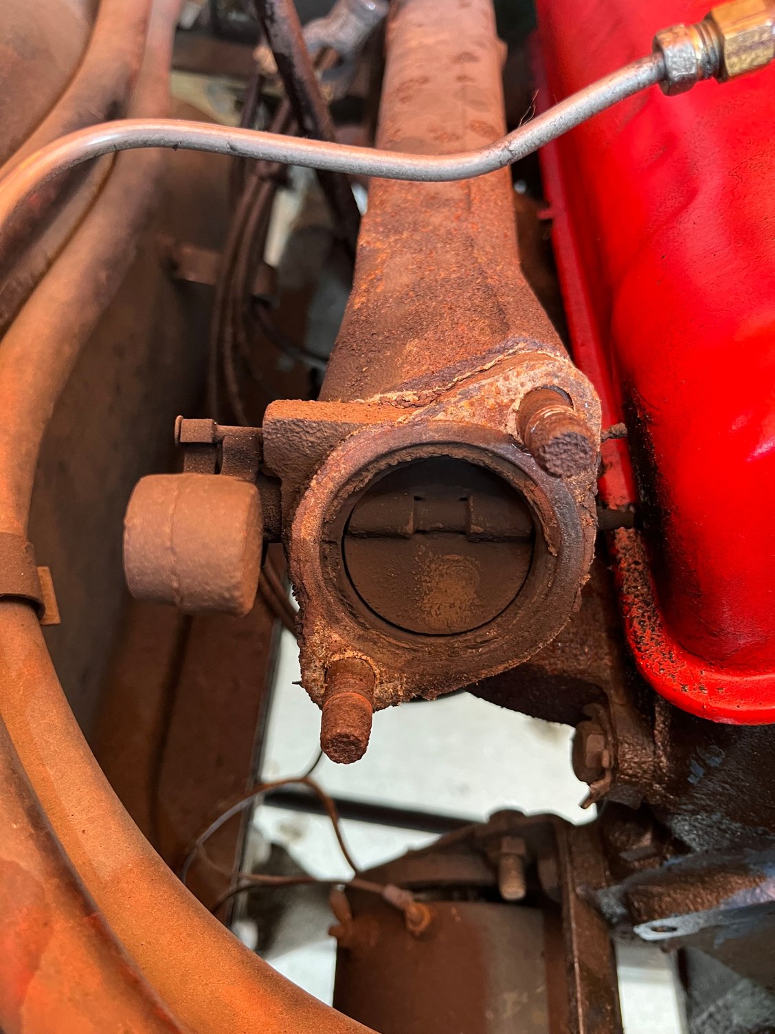

Overhauling my 292 Y-block in my 62’ F100 Unibody.
Pulled the crossover pipe and noticed the ECV is very biased towards the closed position. Shop manual says it should take very light pressure on the counter weight to open the valve against the spring pressure. Parts manual doesn’t even show it. Should I replace when I install the new exhaust system (I’m replacing all the pipes) or just go without.

Look at it.
Is there one good reason NOT to replace it?

Ditch it for good

Since you are in Michigan, if you drive a lot in the winter you might want to replace it or repair it. Keep in mind if that thing has been like that for a long period of time the crossover passages in your heads and manifold may be full of carbon and even a new heat riser valve won't make it work correctly. I've seen the crossover passages completely plugged up in high milage oil burners.

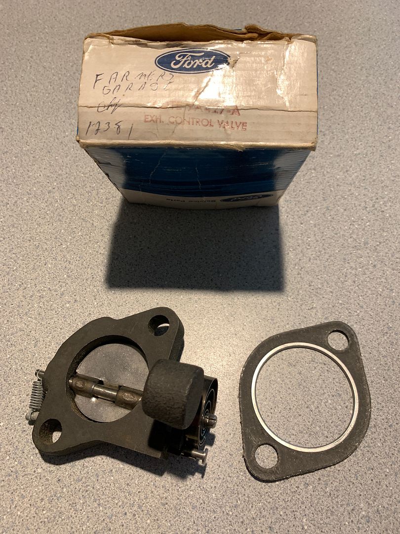

Have a look at this one, on eBay. Not listed under the part number, but might be it. If that’s it, looks a whole bunch better than what you’re working with, and only 25 bucks.

Great, just bought it. Looks right. Thanks!

Great find Buzz! Way to go!

That was a steal, well done, you asked at the right time. I recently bought a casting blank (without the valve flap) for more than that!

Perfect fit. Thanks Bud.
