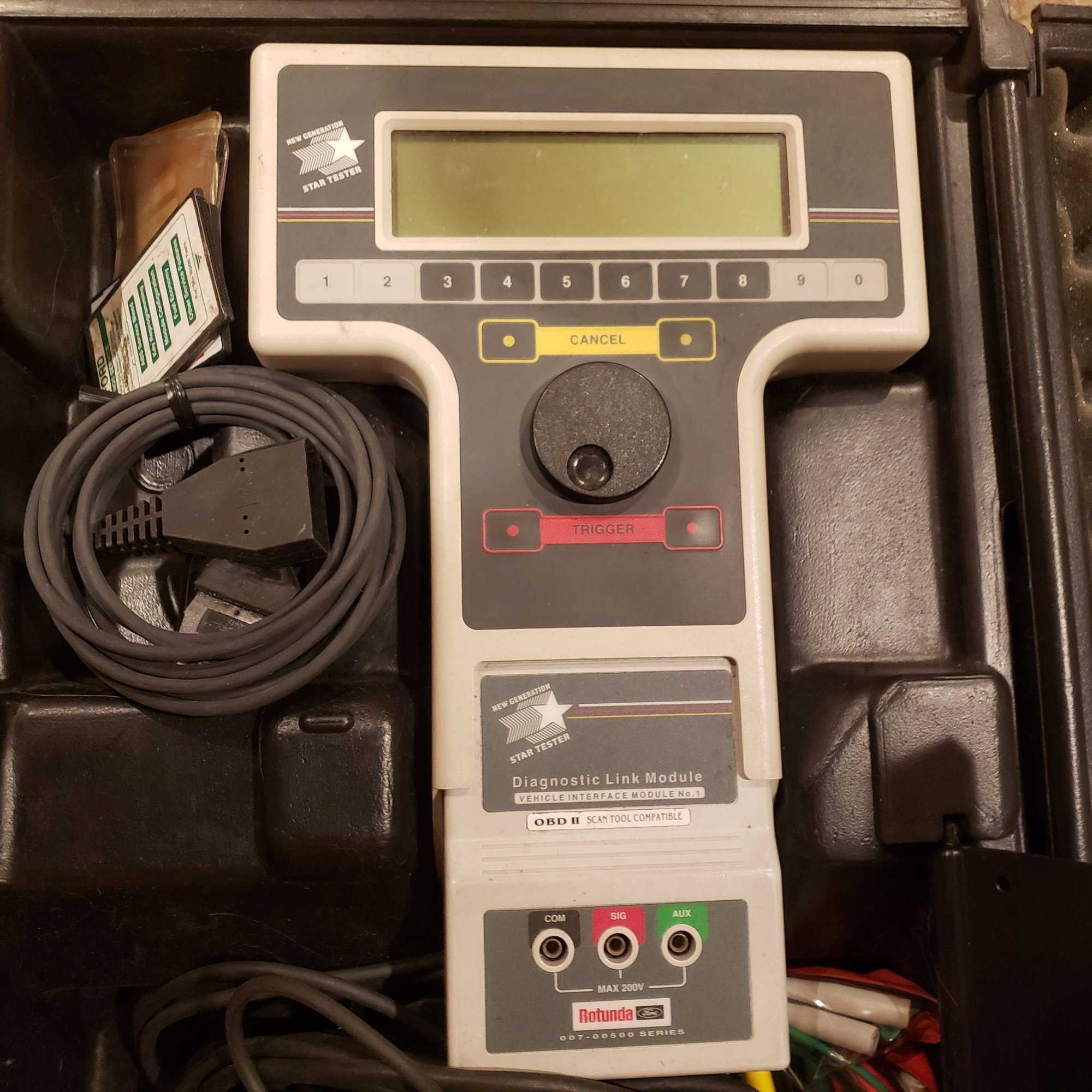

On a 1996, there is a whole bunch of tests you can do with a NGS, if you think it ruins crappy
Yours should be EEC5 with a maf sensor
That means you can make it sing, dance and explode with a NGS, check pids and all of that
Enjoy that 4.9

Are you offering to loan your New Generation Star tester to the OP to run those tests?
