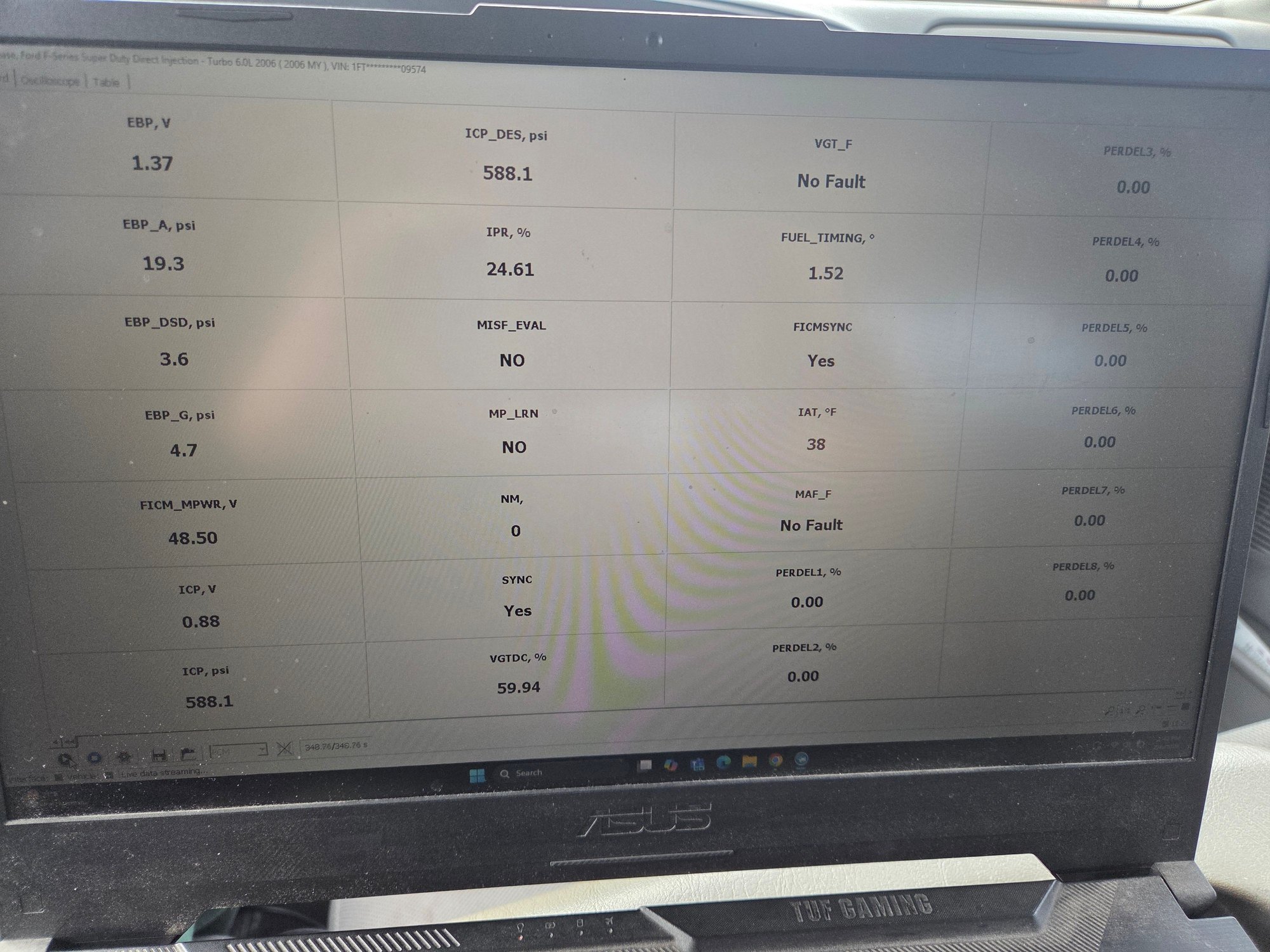

Forscan ebp data
I am hoping someone has some insight, or maybe a picture of some good ebp readings from forscan. My readings seem off, for ebp dsd it will read around 3.7 to 4.7 at idle, the edp g usually matches the dsd. But the ebp actual will read 19.5 ish when the other 2 are around 4. All psi readings. I don't have any codes, except for egr, which is plugged off I just haven't taken the cooler out yet and put in the j tube. I have always assumed my stumble/ miss was injector stiction. But now I'm wondering if the ebp is faulty, or maybe I got the wrong one when I changed it a couple years back. Any thoughts on this are much appreciated.

EBP is an absolute pressure which includes barometric pressure. EBP G is gauge pressure, so pressure above barometric pressure.

Ok, so what your saying is, g is gauge, and desired matches gauge. But my actual is quite a bit higher, indicating an issue with the sensor or tube? I did pull it and clean it and the tube last summer when I replaced the pigtail, so I probably have a faulty sensor, perhaps. Thank you for the reply Pikachu.

Your actual and gauge readings are the same. Gauge pressure is absolute pressure - 14.7.

No, I'm saying EBP_A is absolute, so it will read higher than gauge pressure by whatever the atmospheric pressure is.

Ahhhhhh, thank you for the clarification. It seems I just need new injectors. Thank you for the replies. I need to get my snap on scanner from the shop and go down the injector contribution rabbit hole and go from there.
