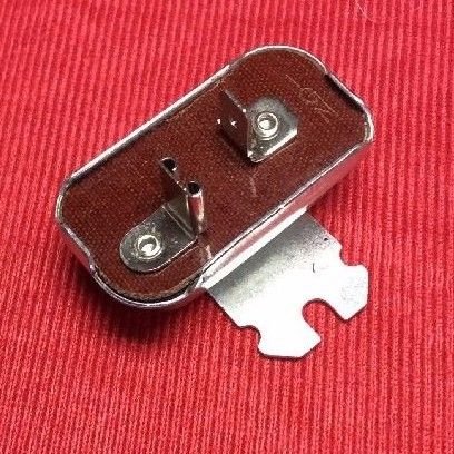

hi ! 12 volt battery , i installed a alternator . if you want the gauges to work you need a voltage reducer . i can look up the name runtz i think !!!

thank you-so just the battery and alternator and voltage reducer? And yes if you could get me a link or something for that reducer I would be grateful!

I'm very happy with the 12 volt conversion for my '39 p/u with an 8ba.That said if you want to convert to 12 volts do it. After all it's your truck. Used a one wire GM alternator. I initially ran the 6 volt starter but for no real reason I upgraded to an original looking 12 volt unit from Joe's Antique Auto with an original style Bendix. I used an instrument cluster voltage reducer for the gauges. This example is from Ebay but they are available from many suppliers.NEW 1961-1966 FORD TRUCK INSTRUMENT / GAUGE CLUSTER VOLTAGE REGULATOR
https://www.ebay.com/itm/16531733833...rSjxdFDKkI9F-c

Speedway Runtz 12-Volt to 6-Volt Voltage Reducer
