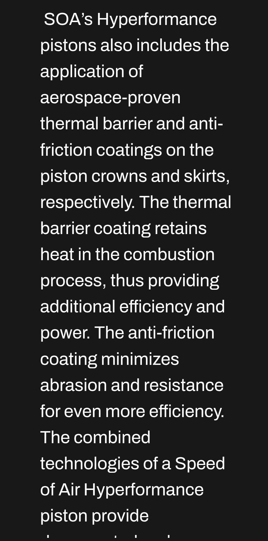

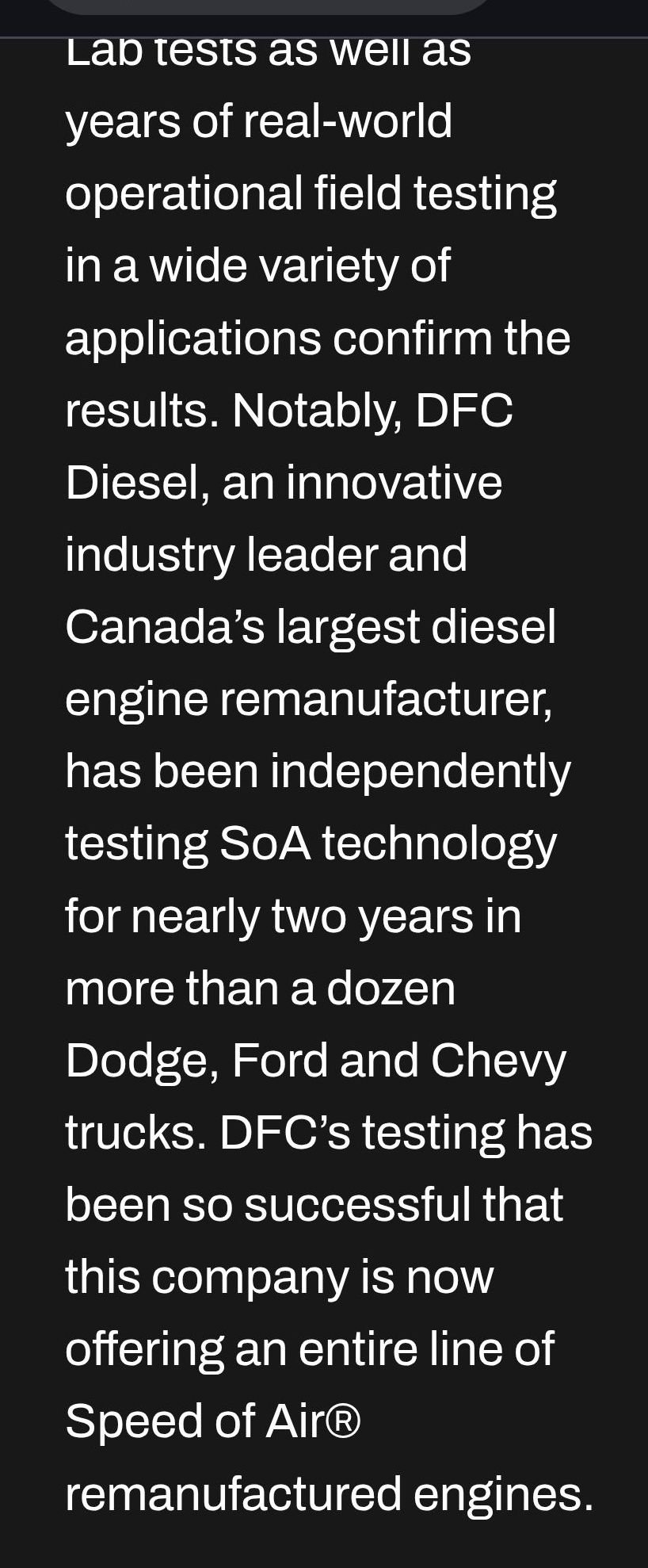

Dave also installs SOA pistons...

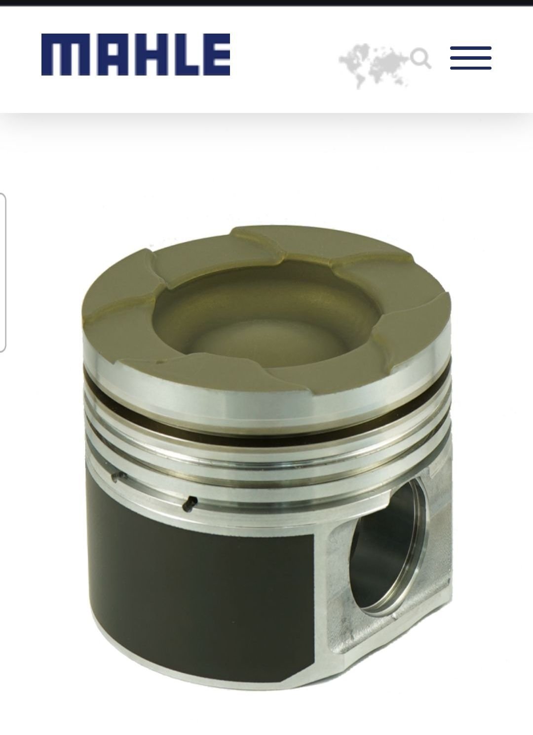

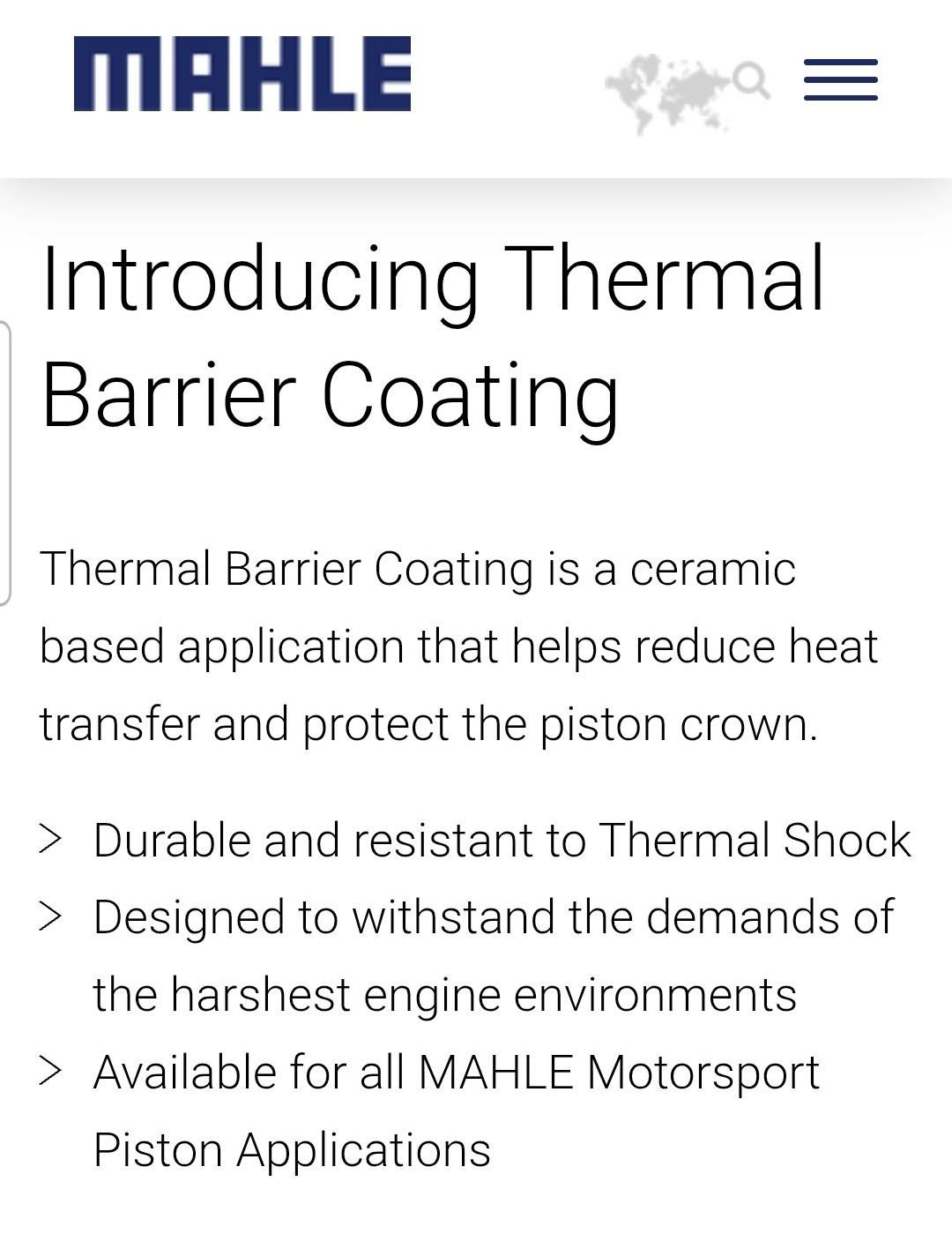

Don't these pistons have a ceramic coating? If so I would be concerned about long term durability of the ceramic delaminating and scouring the cylinders
The 5.9L Cummins QSB came with coated pistons. And guys have been putting them in their rebuilds on 5.9L ISB's for quite some time. I'd guess this is a non issue.
They do... not sure on durability but it seems they are not the only ones with a piston crown coating...
https://www.us.mahle.com/en/motorspo...erpak-pistons/
Like mentioned, it seems there are Cummins pistons available with the same technology.
And about the SOA pistons, they have this technology as well.
It seems that this technology is a viable option for those who are willing to pay for this aftermarket option. I also understand this is not for everyone.
