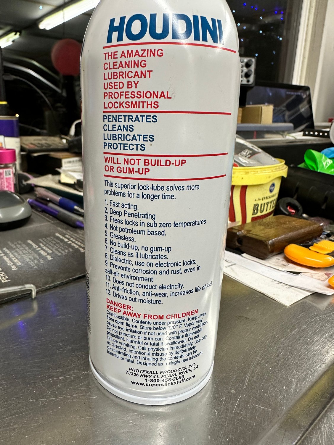

I use this stuff.

I should have clarified, ignition lock cylinder! You use that stuff for the ignition or just doors?
All my locks, house, cars, trucks, bikes.
Just hold a microfiber up to the switch and just spray a little at a time.

What store to you buy it at? Seems hardware stores around me don’t carry it?
Houdini Lock Lube: Automotive Lubricants: Amazon.com: Tools & Home Improvement Houdini Lock Lube: Automotive Lubricants: Amazon.com: Tools & Home Improvement
