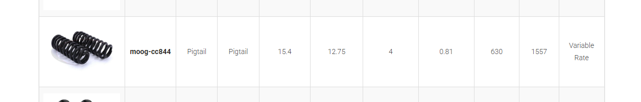

Correct they're all 4" inner diameter.
They vary in wire thickness, winding spacing, and free length.
The 2wd f-250 coils are stiff and short, ~630 pounds per inch for Moog version (cc844). Good for lots of weight and no body roll. Stock half ton truck coils vary but are generally around 375 pounds per inch. Best I recall none are over 400 #/inch.

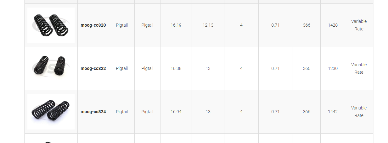

Originally Posted by 5starCabF-3
The big difference in the moog coil springs cc 820, cc822 & cc824 is in the weight capacity and free height. The spring wire diameter, spring rate and instslled height are the same.on the cc-822 & cc-824 13.0 inches the installed height of cc- 820 is 12..19
cc-820 1424 lbs duel shock
Cc-822 1230 lbs. 2wd and 4wd
Cc-824 1442 lbs. 4wd / hd
the duel shock braket is the same except for the extra shock mounting hole.
The duel shock , front lower shock mount and the sway bar mounting bracket add height to the lower spring mounting the shorter free length and probably the shorter install height.
I didn't realize those three were all the same rate but good to know. Here's that data all compiled straight from Moog for reference.
From left to right the columns are: part number, the two end styles, free length (inches), installed length/height (inches), inner diameter (inches), wire thickness (inches), spring rate (lbs/inch), load (lbs), and spring type.

Originally Posted by jas88
If you want a little more lift in the front, ie levelling, use 460 springs.
cc844 yes? I was thinking about it, but want to keep the ride as stock as possible
