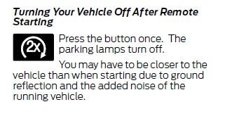

G’day all! I have a ‘17 F250 SD with the 6.7 Powerstroke. My question regards starting and STOPPING the engine using the remote fob.
I know that I can start the engine remotely and that I need to enter the truck and hit the start/stop button to activate all the systems.
my question is…can I power down the engine remotely without going into the cab? That is, power on, then power off remotely, using the fob; and if so, how?
TIA

From my 2017 owner's manual ...

Yeah, same as remote starting, but, of course, it won't remote shutoff after being in full on mode.

I use the Ford app to start my 2019 6.7. The slidier on the app will do a shut down also. Not sure about your year but worth a try.
