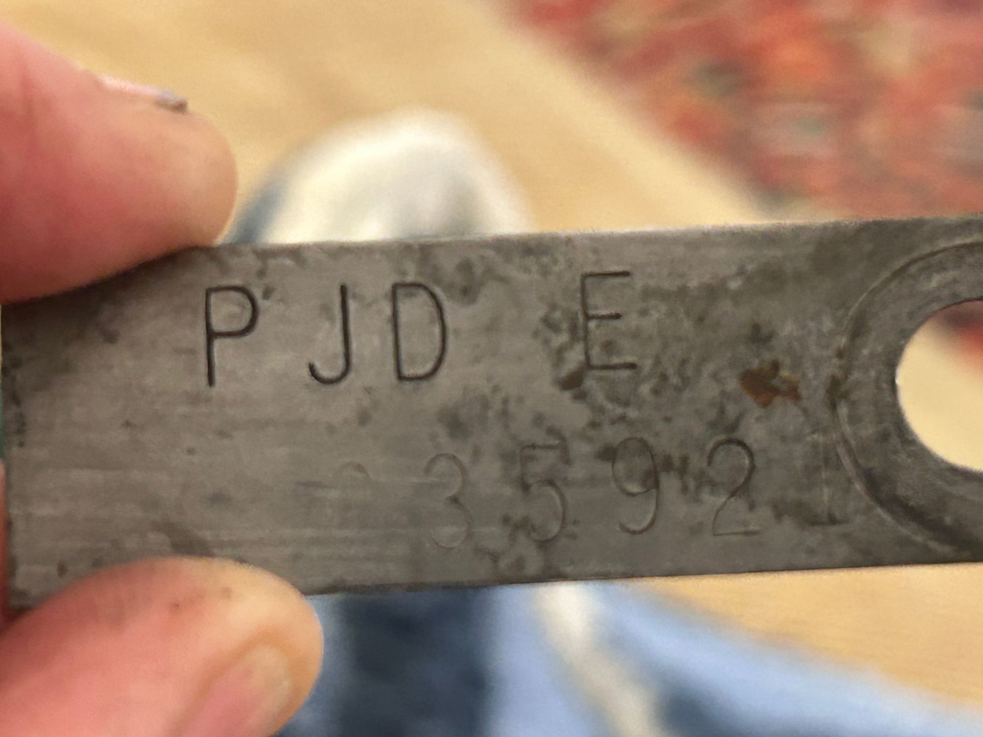

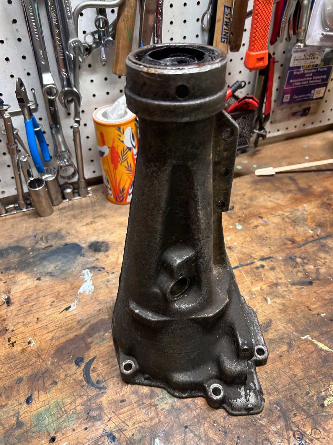

The core is a PJD-E. I think it’s a 1970 T-bird unit from a 460.
Tear down is in progress. Started with output shaft.

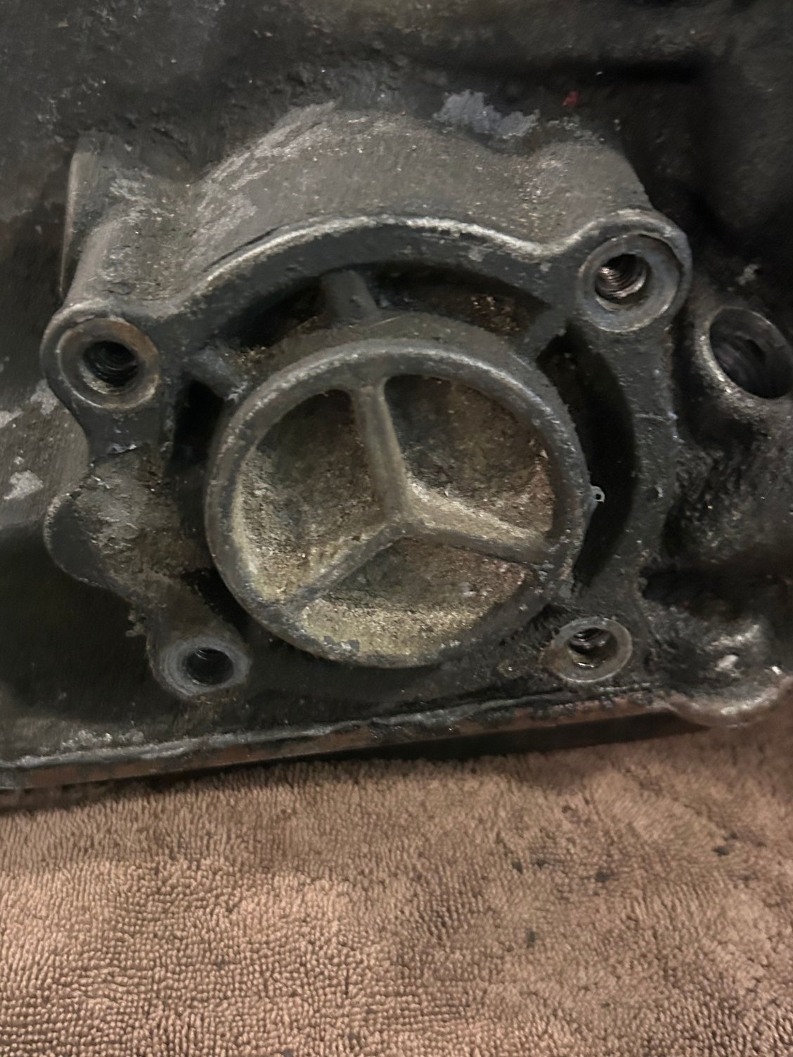

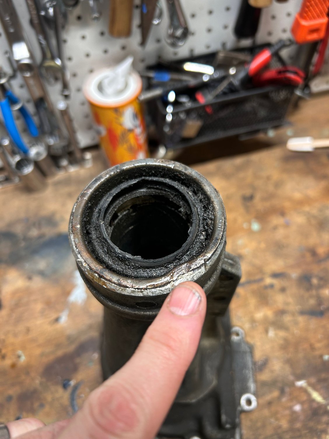

Noted some damage on the rear seal that I’ll clean up when it goes back together.

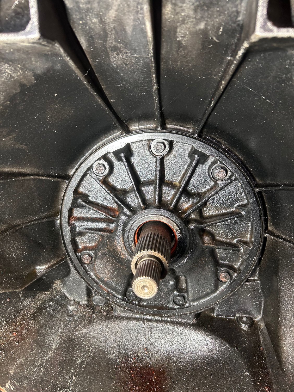

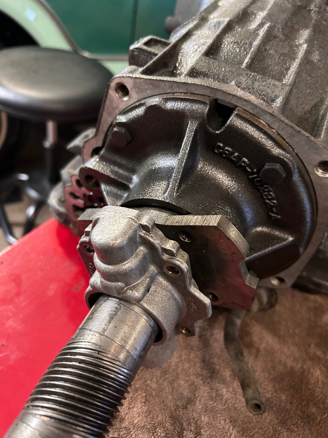

Turned it around and removed the pump bolts.

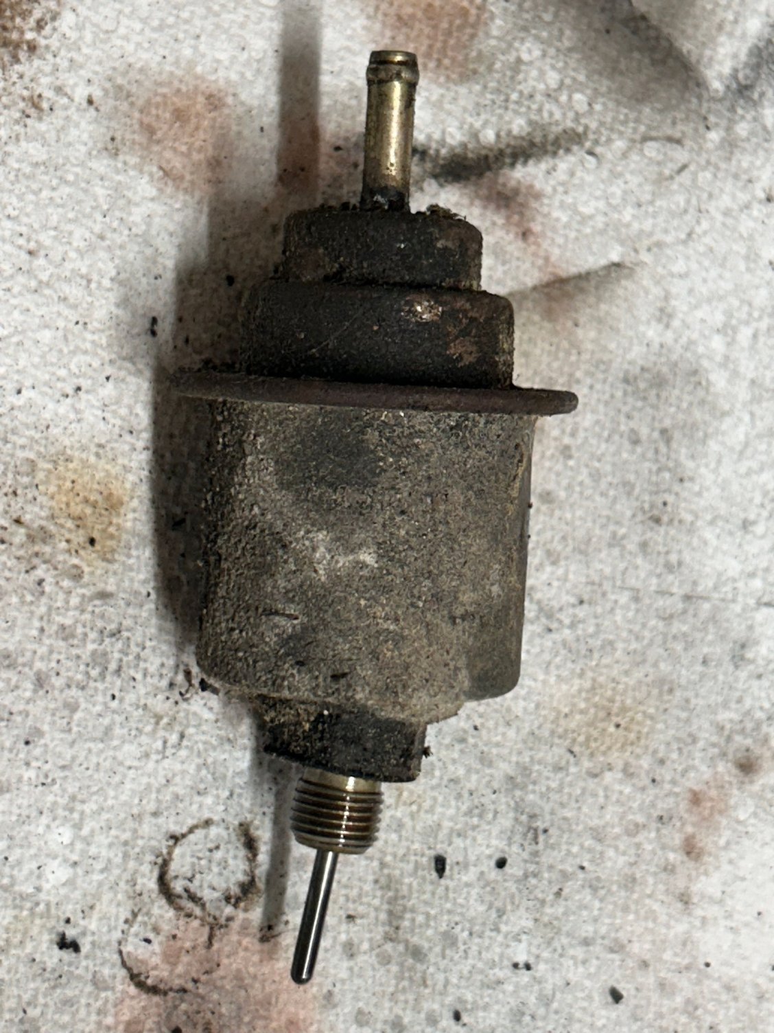

Front side, removed vacuum modulator.

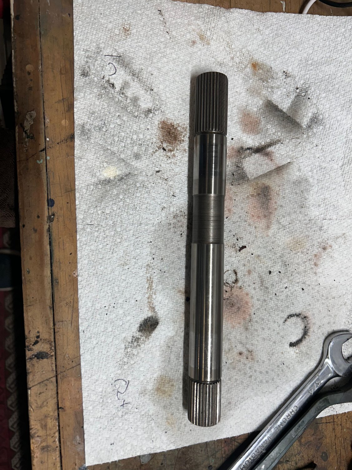

Removed the output shaft.

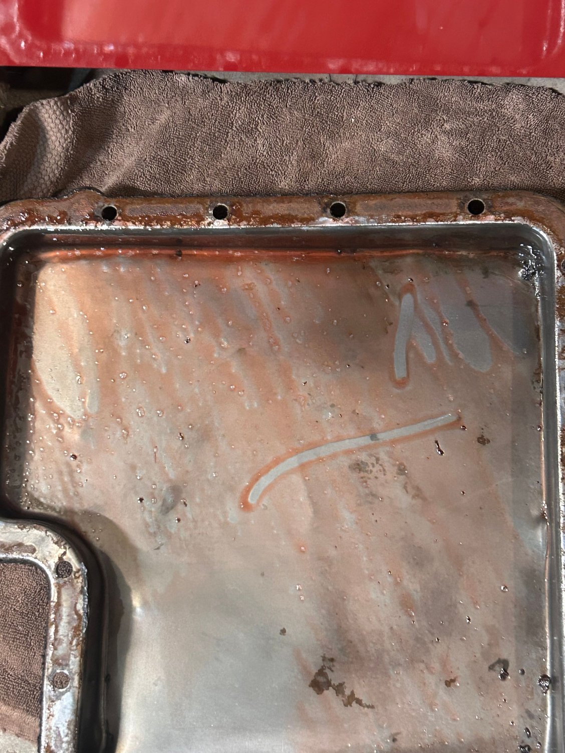

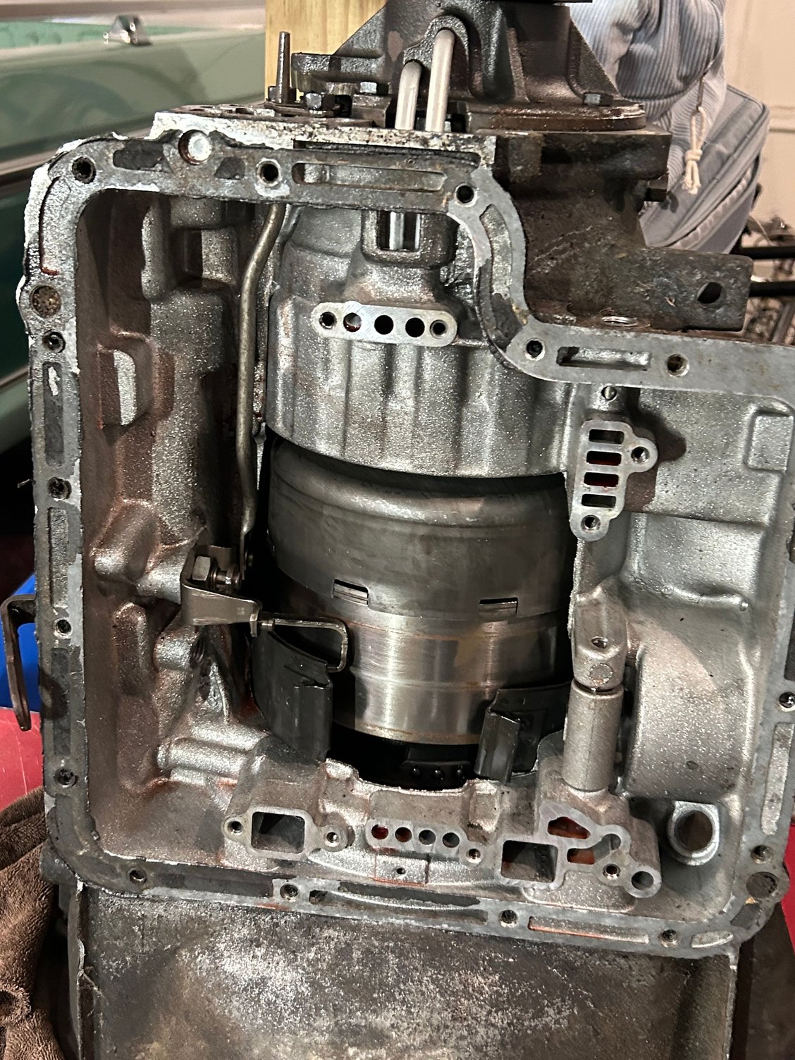

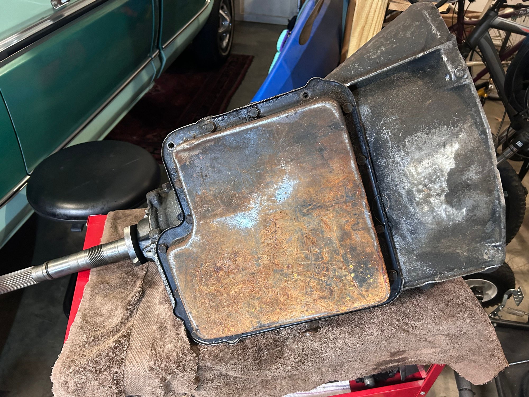

Flipped the unit over to work on the oil pan. Nothing bad seen in the pan.

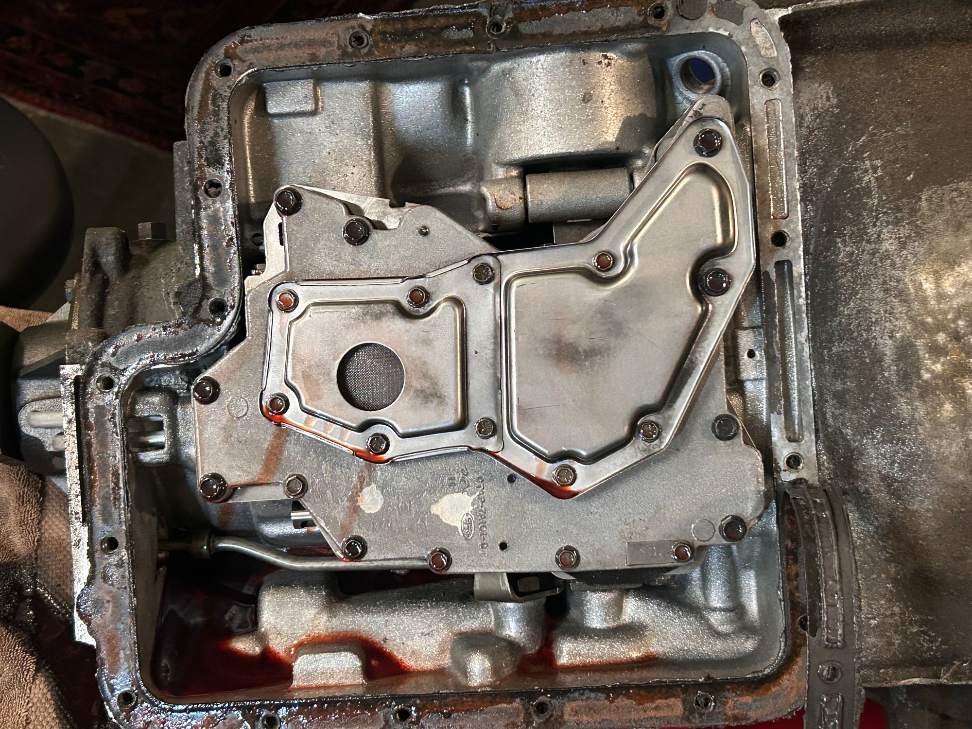

Removed valve body.
