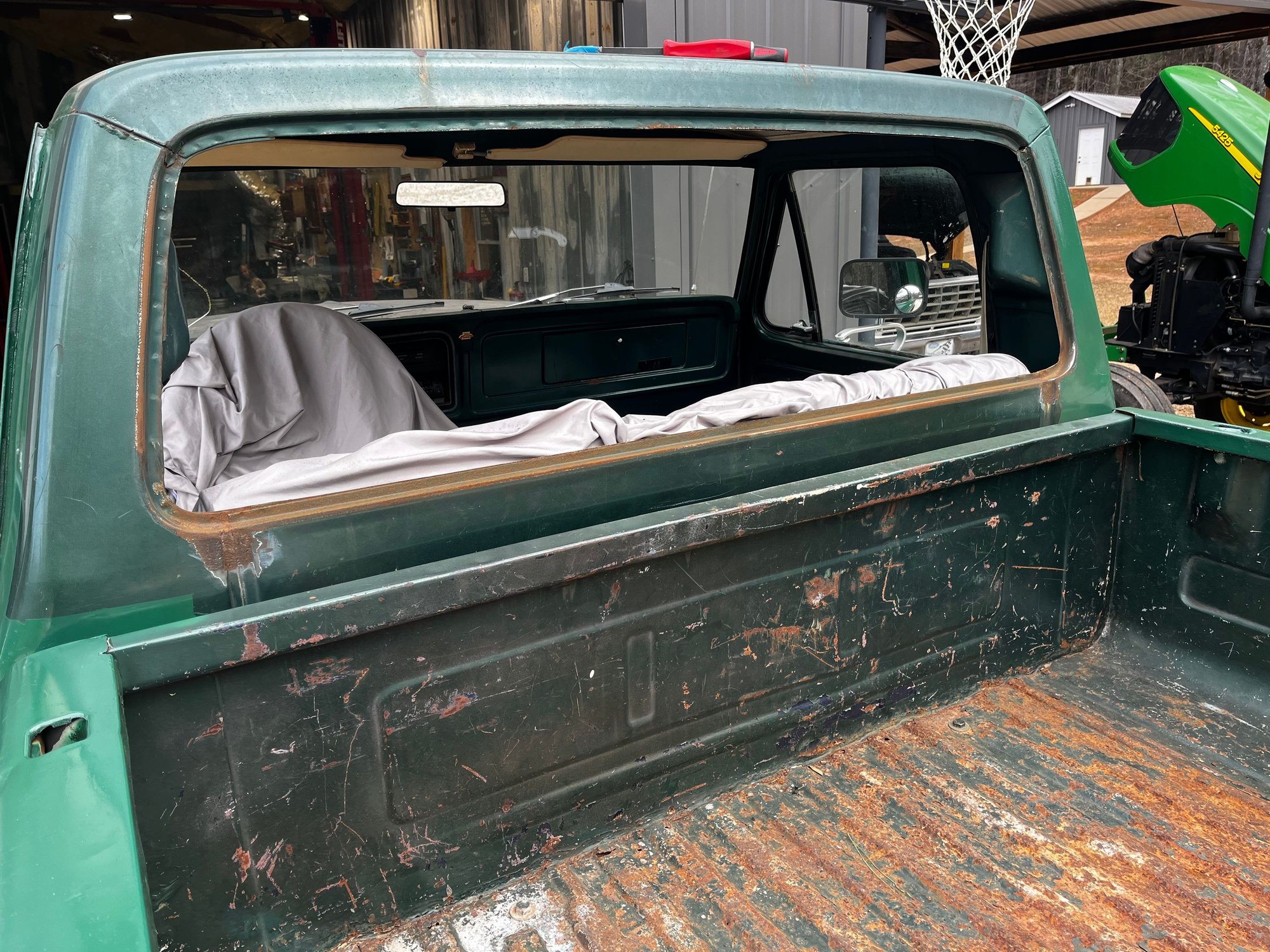

I thought I would try a rear slider window from Amazon. It was out of the box for 2 hours before I packed it up and shipped it back.
My opening is straight. The Amazon window was not.

I'm not quite sure how to proceed. I noticed that with my original slider window the rubber does not touch the frame and that means that it can be trimmed a bit, but I am relunctant to trim without knowing if it will help. I guess I will find out.

Thanks for the photos, Kubata. I can see by your photos that I have been trying to install the rubber backwards. That wide 'lip' goes on the outside! I wonder if that will make a difference. I am going to trim the protruding lip on the frame, flip the rubber around, and try once more. Thanks again.

Yes sir, I tried first with a rubber the right way seal and lmc truck solid glass. I couldn't even get the seal to stay on the glass much less into the truck. I got fed up and ordered a good ford takeout glass with a good pliable seal already installed. I like the newer style latch. Just roped it in and used some soapy water, , a pick tool and my wife.
