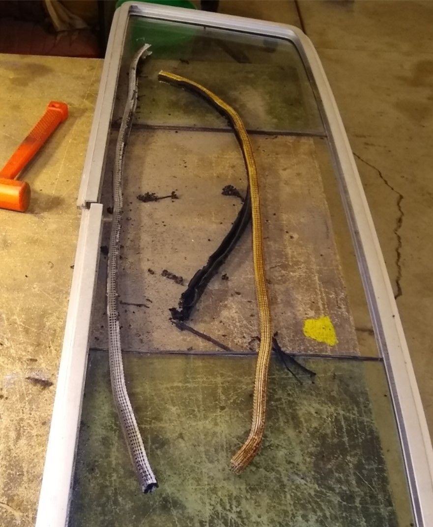

This what I used for the slider channel,
Glass Run Channel - cut to length
Same stuff that that came out.( not my window, ford-truck.com pic)

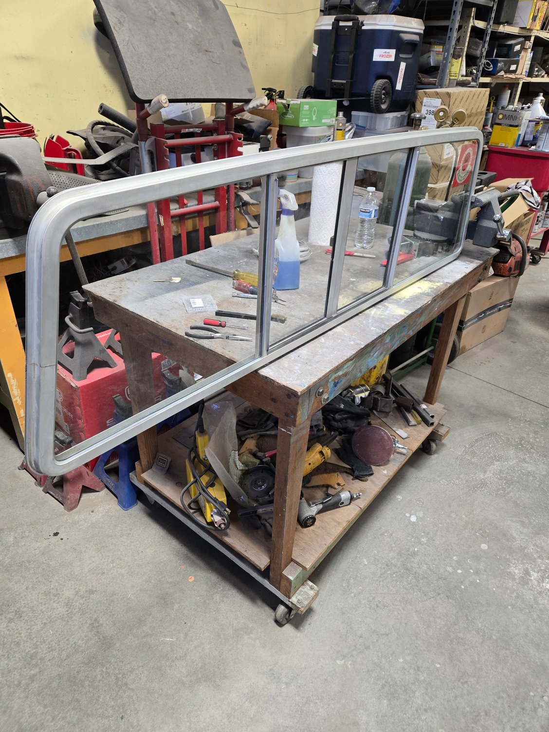

Even though my rear sliding window has the plastic insert on top, I think/hope that I can make it water tight. I'll post photos when I do the work, of what I did to achieve water tightness.

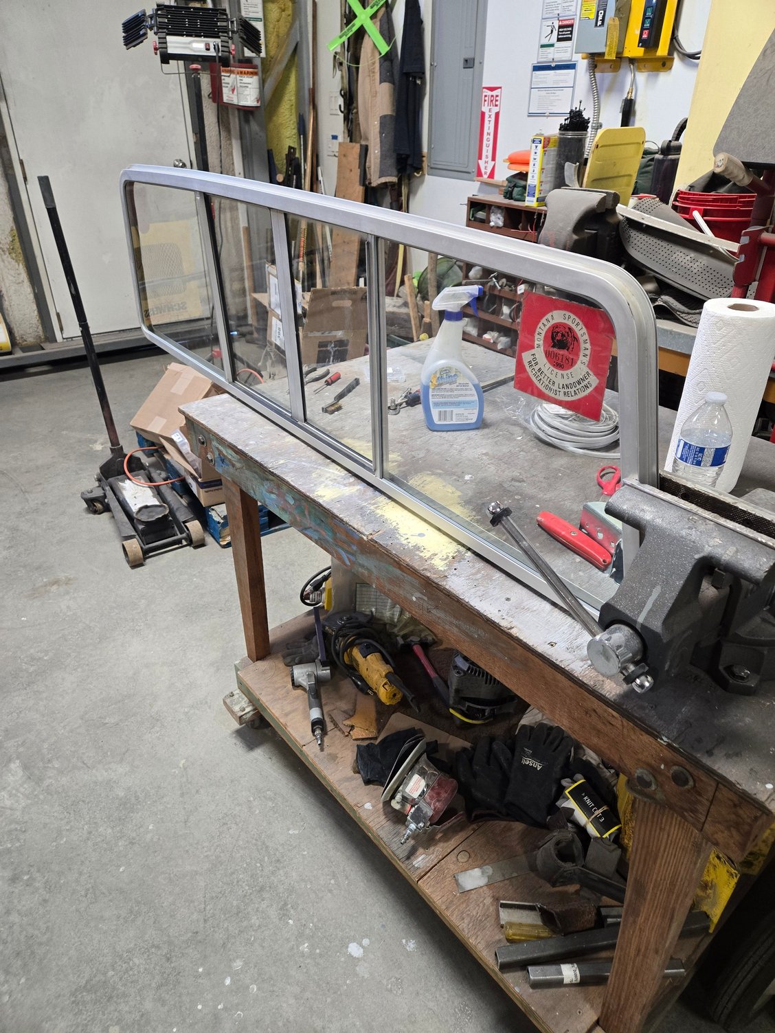

I wanted to avoid taking the slider window apart, but I don't know if I'll be able to do that and be assured that it won't leak. Before, when it rained, I would find water inside the cab behind the seat. I want to make sure that is not happening again, but am not sure that I need to rebuild the window to make it water tight. What do you guys say?

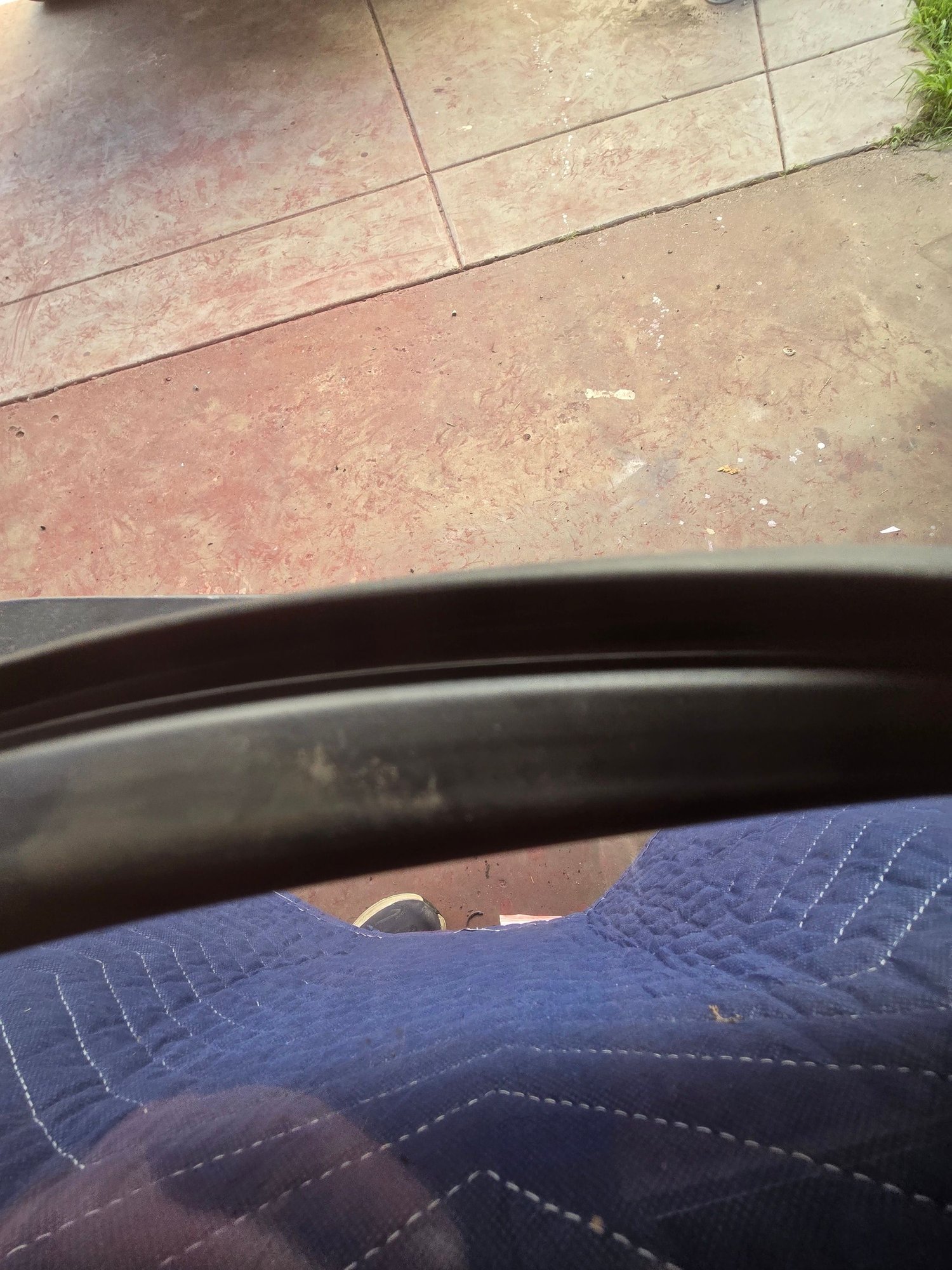

Can someone help me get oriented with the rubber seal? It seems that the metal ridge around the window opening goes in the narrow groove and that the window or slider goes inside the wider groove, but which side of the rubber faces the outside?
One side of the groove is wider than the other. Which side faces outward?

I cleaned up my slider rear window and got a new rubber, and tried to install it several times, each time with the rubber in different position. It was impossible. At each top corner, there was zero space to pull the rubber through.
I can't understand. That window was in for 30 years. How could it not fit now? The only explanation is that the rubber is different. And I don't know what rubber was in there or where to get it.

The window came out of this truck. Now it will not fit. The only difference is the rubber.
Does anyone know of another type of rubber for out rear windows?
