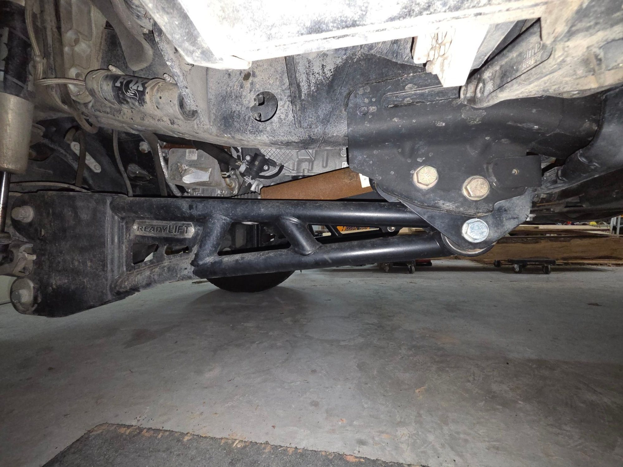

I have the new bushings for the radius arms. The tool I have doesn't have a big enough cup. The bushing itself measures 2 7/8". Has anyone done the bushing replacement and with what tool?

Which tool kit do you own/using?

The ICON kit from Harbor Freight. The largest cup isn't big enough.

The manual for this kit lists all the sizes.

Thanks! I'll take the bushing with me.

There's an add on kit with more cups
https://www.harborfreight.com/ball-j...ece-58785.html
