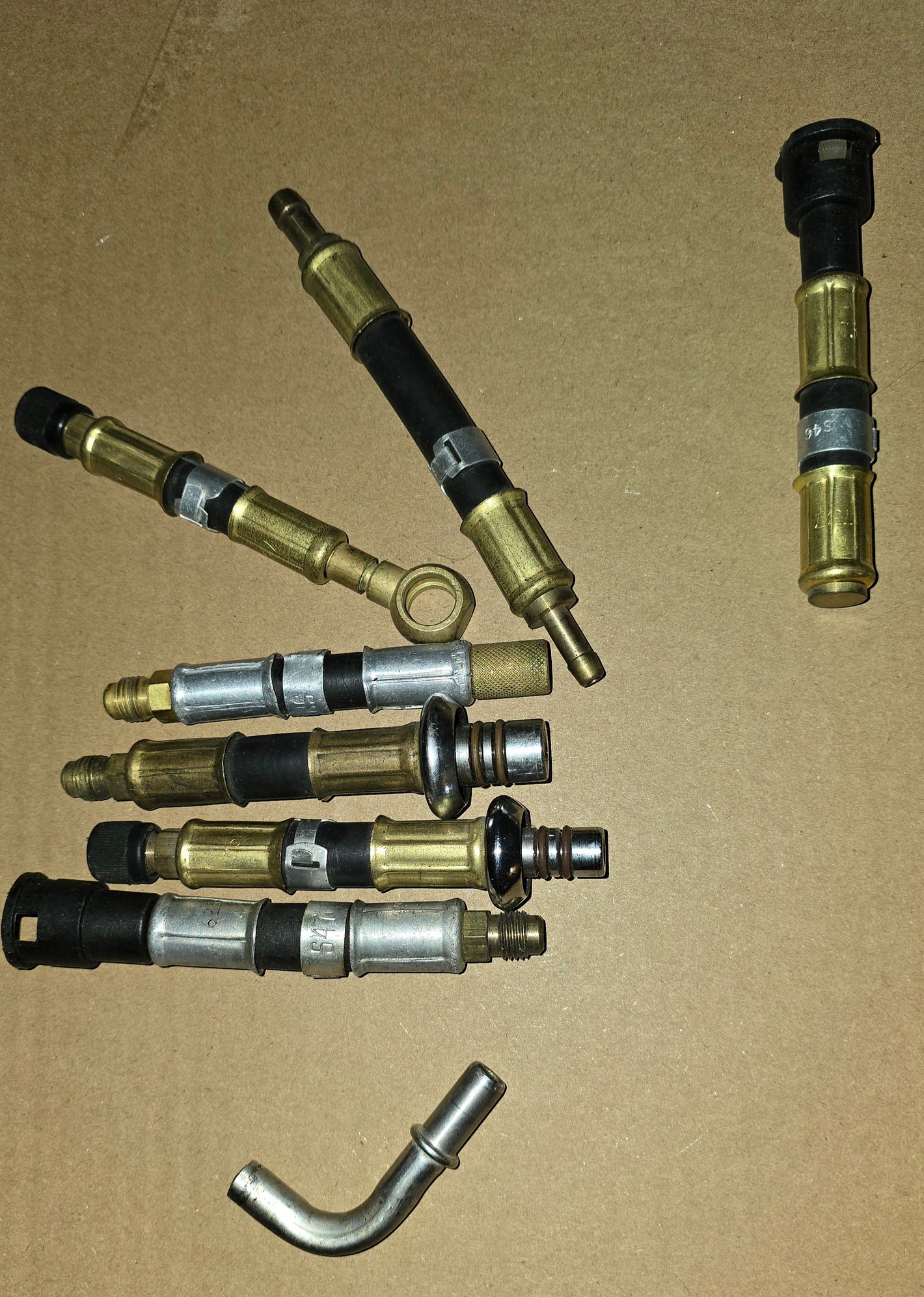

There is no place where it's rubber and you can pinch off
It's hard plastic all the way and will crack if you try to pinch it off
Ford made and gave us numerous block off and adapters for our fuel injection cleaning equipment
You can find other ways to block off the return line but generally you will just test the pump itseld before the filter or regulator to test the pump
Right, check for 12 volts initial prime power to the pump, at the pump connector
Realize that juice goes through the tank selector switch to get to the pump
The one on the far right is a return fuel line block off tool.

Thanks for the warning and the great idea. At this point I hope it's the pump because I paid 800 bucks to have it replaced and the warranty doesn't run out till the end of February.
