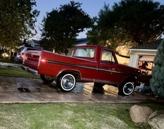

Hello,
About 5 years ago, I installed a completely new braking system (rear drums, cylinders, hose, hardline, and front disc kit, booster, master, combo valve, hose, hardline) on my ‘72 F100 2WD 429/C6 project truck. I test drove it to bed the brakes and it’s been parked in the driveway ever since. Since that time, I have temporarily removed some engine bits as well as the steering box and booster/master in order to install a new tilt column, but the project stalled about 3 years ago.
Recently, the problem is when I attempted to push the truck, the front wheels wouldn’t roll. I jacked it up front and rear to investigate and nothing seemed amiss. I figured the disc pads were clamped under pressure so I removed the brake hose at the calipers and removed bleeder screws, and some fluid spilled out. Then manually pushed the outer brake pad away from the rotors causing some more fluid to pour out, but the wheels still won’t roll. There’s a complete coating of surface rust on the new rotors but could that really prevent the wheels from spinning?
Any idea what I should try next? Thanks!
Terry

So… I took the wheels off and, of course, there was a full dusting of rust, but surprisingly the rotors broke free and rotated rather easily. I scotchpadded off a healthy layer of crud until things spun freely. Then bolted up a wheel and everything came to a screeching halt again. Apparently these chrome smoothies do NOT fit my front disc brake kit!
In hindsight, I had swapped the smoothies on last summer, but never drove/rolled the truck with them on, so I had no idea things were binding. I’ll be taking a closer look with a grinder in hand to hopefully massage things into place.
