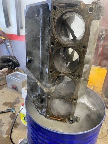

Hi folks
We broke the heads down on our FE 360 this past weekend. I've attached a couple of pics of our hot-tank (worked great for the record!). My question is regarding valves. The valves on these heads are in pretty good shape and measure 0.3710 and 0.3690. New they measure 0.3716. Our machine shop originally planned on installing new valve guides boring them to fit our existing valves. Based on the fact that oversized valves are available, I'm wondering if it would be and option for us to buy new oversized valves and have the shop bore our existing guides to match the required tolerance? The oversized valves are 0.3866.
