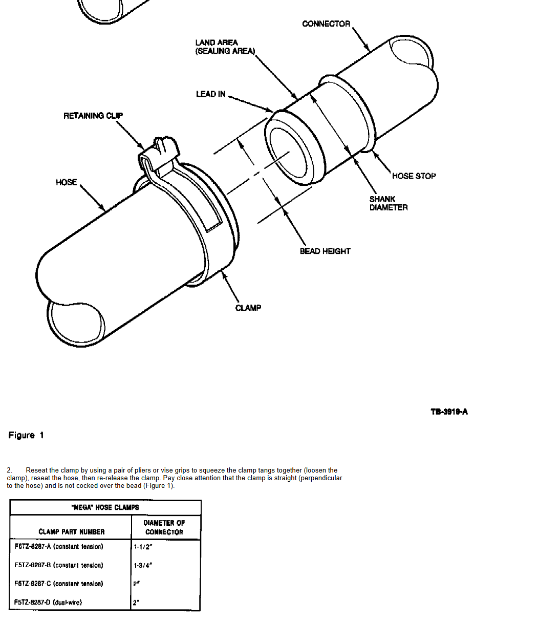

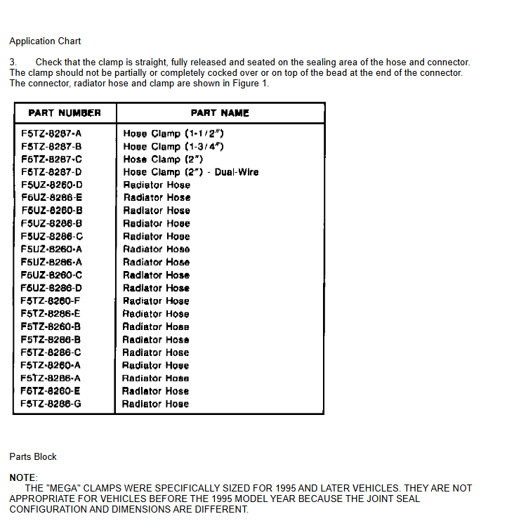

Im only posting this since if your radiator is designed like the image #2 shows, then you should use constant tension (mubea/mega) clamps. if you want OE part numbers, here you go, but you can see the sizes as well generally.
