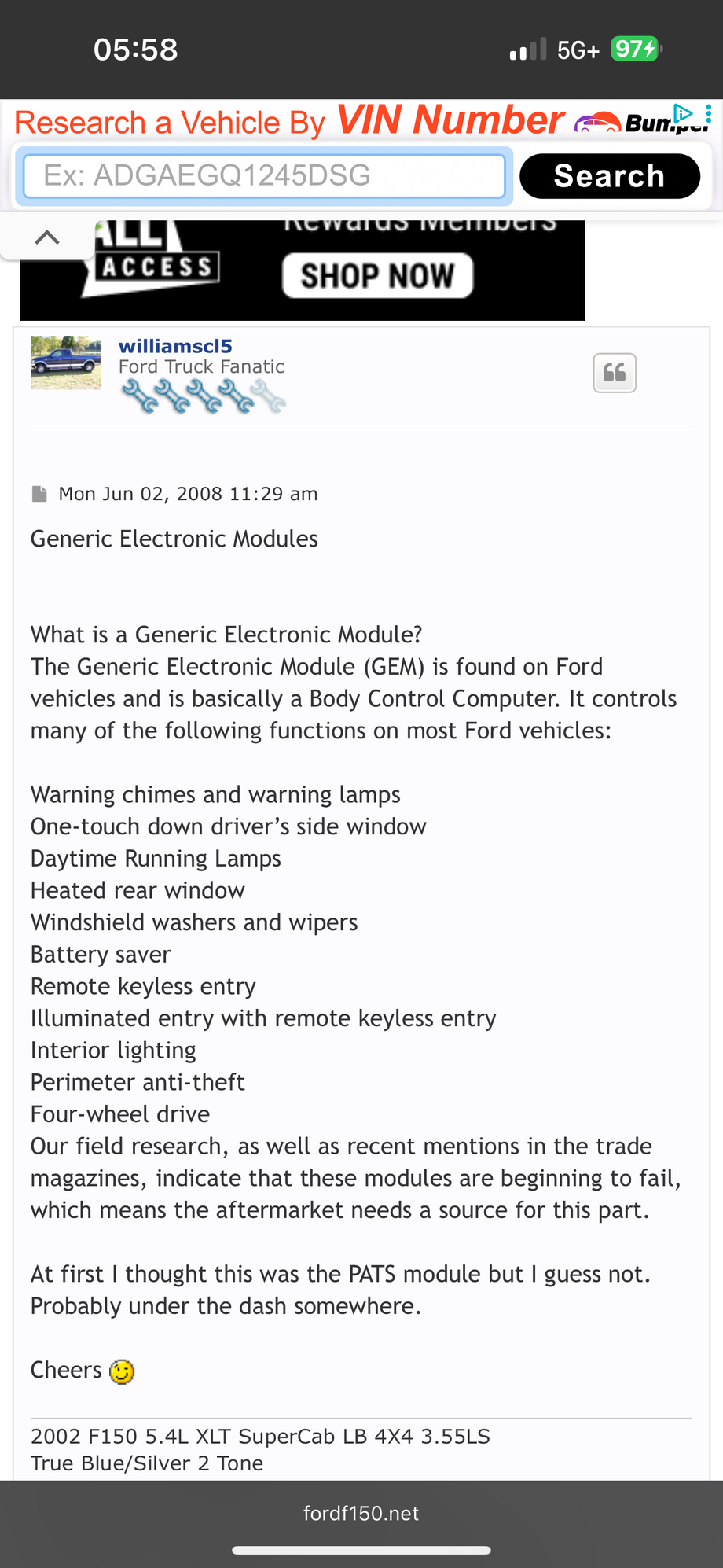

This sounds like a GEM issue. You may need to get a look in the fuse box area and check for corrosion. If you’ve ever let a leaky windshield fester (all 10G owners have this happen, so fess up), it’s coming back to roost.

Agree with what's said.Just pull your Gem.On it is a Exact model number,in order for you to Get the correct either refurbished or new.This part number is Specific to the truck and Ensure the correct part. I mean showing 1 I replaced in a 98 f250 for reference So you can See its number model.Price on these $149-$249 Ebay .
