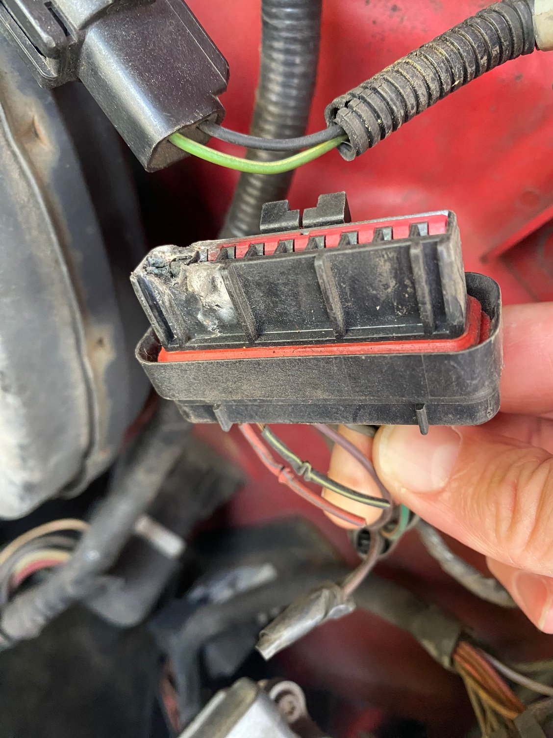

Update!
I was poking around under the hood and I found that the wiring harness to the Cruise Control Module was DXed. That must have been what the Auto Shop pulled so long ago. I would have just reconnected it, but the black and red wires are snipped and the connector pins on the Connector were fried out. Looks like I’m going to need a new wiring harness.
Mystery solved, but I’m disappointed bc this repair will be a LOT more complicated than a clock spring.
Thanks for all the input!
