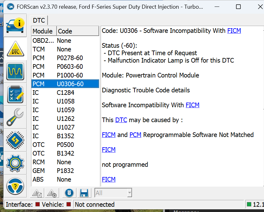

Old Feb 24, 2026 | 05:19 PM
  #28
OneTon4Fun's Avatar
OneTon4Fun
Joined: Jul 2007
Posts: 235
From: north carolina
There is no smoke from the tailpipes. Could it be the FICM?

Well after putting in a new FICM I get the same diagnostic message about the FICM. So I am concluding the Forscan is showing a false fail. The #6 injector will be the next to get checked.

The diagnostic message is from the PCM. FORScan just reports what the PCM is telling it when it pertains to codes.
A single injector code is typically not a FICM issue, but it has happened, especially on the early 7 screw FICMs that had individual drivers.
