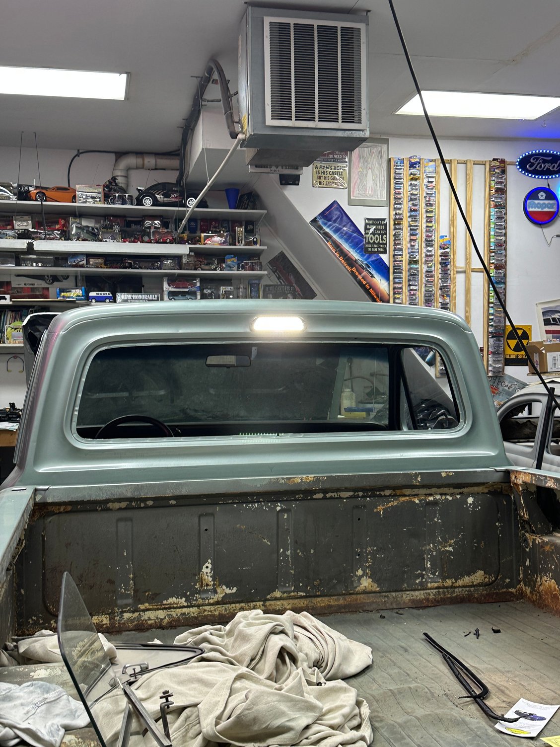

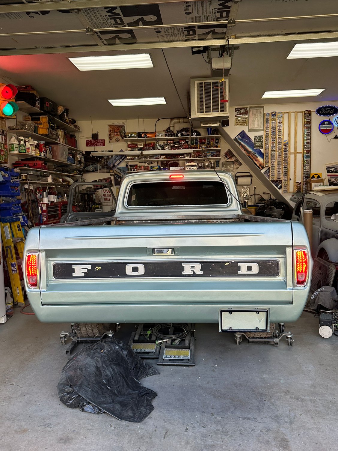

Fixed Dome Light
I ended up taking the whole light switch because I could back feed the dome light and it came on. So bench tested the light switch and there is a tiny little micro switch built into the light switch that is the dome light. Did a continuity test and it was good so reinstalled the switch and plugged it back in and still no workie. Started testing and bingo pushed the green/yellow wire into the light switch and it came on I think the wires were pushing out when it was plugged in. So that is fixed.
with the cargo light and then the brake light on.
