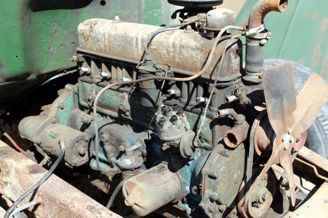

I got my 300 six today. It came from an '83, or '84 F100 with 82k miles. My next move is to go get an AOD trans that I have located. Then I will be gathering up the necessary parts to make it all work together.
